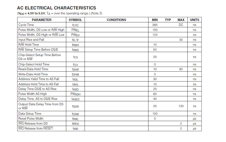

Hi i wanted to write code for the DS12887 with a PIC and was looking at the timing waveforms,what got me thinking was that two parameters that have upper limits on the time.
Read-Data Hold Time tDHR
Output Data Delay Time from DS or R/W tDDR
I am using a 18LF4620 with a 4MHz crystal which gives me a MC of 1us.
Here is an example code i found for this purpose written in CCS compiler,i can write the code but before doing that i wanted to ask about the delay problems...
It uses a 16MHZ cryatal with HS i-e .25us or 250ns MC.

So if i just use 1us will it cause any problems?I dont think that i will have to put any nops in between.

Those are read timings that have upper limits. They are the maximum times that you have to wait before the data is guaranteed. That is also the minimum time that you should wait before reading the data. There is no maximum on the time that you can wait before reading the data.
