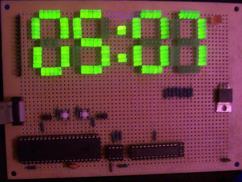

I am using a DS1337 (Not the C version) and every time it the minutes reach over 39 (so 40) it changes to 00. I know its the chip and not my code because i never write to the DS1337 unless its to set time which is done by buttons. Any thoughts? Faulty chip perhaps?
So my issue is i set the time to 7:45 and it changes itself to 7:05.
If i set to 7:38 its ok. Works fine untill it hits 39 where it jitters then 40 changes to 00. Any thoughts?

Is it possible you have one of the alarms set and the interrupt is somehow causing a reset. If you look at the alarm registers one of the modes is alarm when minutes match.
Looking at the pinout, a solder bridge between pins 7 & 8 could cause a reset when an alarm happens.
THANKS! you made me think more lol i found the issue:
BAD:
        min_h = t_temp << 2;
        min_h = min_h >> 6;
FIX:
        min_h = t_temp << 1;
        min_h = min_h >> 5;
Wow this sucks. I set the time to match my cable box time. When i woke up today it was about 40 minutes ahead of my cable time. So i reset the clock to 7:30AM to match my cable time and not its 8AM but my clock says its 8:02AM. Any thoughts on the timing issue?

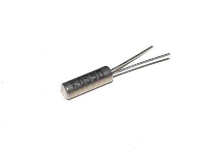

Mine keeps perfect time. Are you sure your crystal is the right type and has the correct capacitors? Can you post a schematic?
i dont have a schematic. Am i supposed to have caps on the crystal ?
Page 6 of the DS1337 Datasheet:
"The DS1337 uses an external 32.768kHz crystal. The oscillator circuit does not require any external resistors or capacitors to operate. Table 1 specifies several crystal parameters for the external crystal."
I used:
32.768kHz crystal - dipmicro electronics

I understood there were 6pf and 12pf type 32768 Hz crystals. Does your DS1337 Data Sheet specify a crystal capacitance? Could the timing be affected by using a crystal with the wrong load capacitance?
Mike
<added>
Data Sheet says to use a 6pf crystal...
how would i measure my crystal ? I dont have a datasheet for it or really info on it. The only lettering on it is:
K0S50 or KDS50 or K0S5D or KDS5D
well it looks like the picture in my previous post.
The crystals I order from Mouser or DigiKey list the load capacitance. I'm not sure what you got from that source...
Regards, Mike
