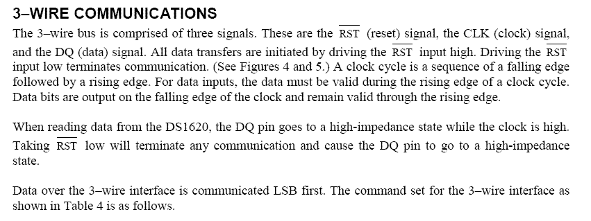

Ive used I2c devices before, but this 3 wire interface is killing me. The datasheet explains nothing.
when do i read/write each bit? is it after a rising edge on the clock line or is it like i2c where i read/write when the clock is high?
in the datasheet there is no explanation.
