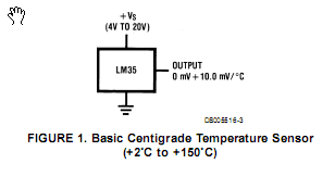

I'll jump in while Mike sleeps.:)
If you have a voltmeter, measure the voltage on the output of the LM35, its 10mV/Cdeg. The datasheet will explain.
From that measurement you should be able to determine which tempr is correct.

Did you measure the LM35 output voltage.?
I measure the LM35 output voltage with an Multimeter - Fluke DT830B, on scale of 2000 mV. The result is almost similar with the thermometer made with DS18B20+12F675+Nokia display (code attached).
