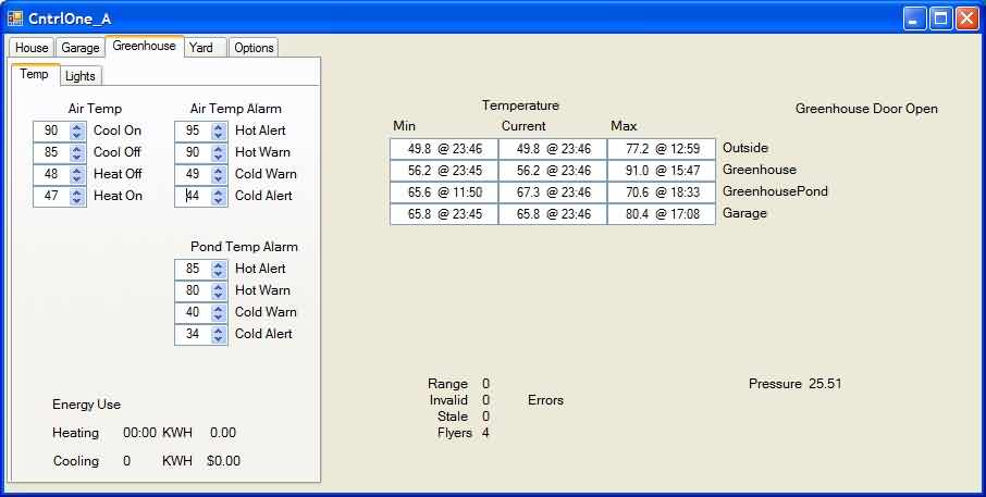

The C# program CntrlOne is work in progress. It depends on 1 wire devices to monitor temperatures including water temp in the greenhouse pond. It uses text to voice to warn when temperatures fall outside acceptable limits.
