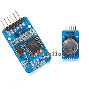

Guys I have a problem with DS3231 chip. Made a clock with a cheap Ebay module & it worked fine.
After 1 month of continuous run the time halted. After searching the internet found that the crude charging circuit & the battery gives lots of problems & need to remove the crude Li cells charging circuit on these modules. I modified the circuit & placed a new CR2032 battery.
The problem is in a good A/C condition (cool) the time works fine. At home (Hot) the time holds & not counting. The time increments sometimes very slowly.

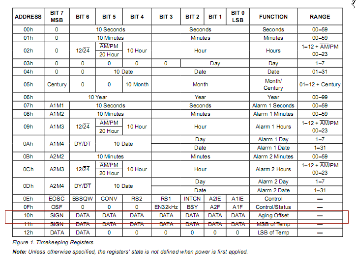

I just guess does the Aging Register have some garbage values after my battery issue? Do you guys set this register when power up the chip?

I suspect your problem is the inbuilt crystal oscillator, which is failing when the DS3231 gets 'hot'.
The ageing register programming just adds/subtracts very low value capacitors connected in parallel with main cap, which I understand is about 6pF.
The ageing register is normally trimmed/set by the manufacturer, you can add/subtract oscillator capacitance to adjust for a 'fast/slow' clock.
I do not set the ageing reg at power up.

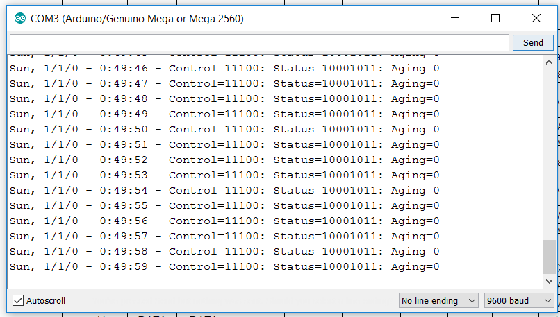

I also monitored the Aging register values of my other modules using a serial monitor.It shows value of "0".Even though if I remove the battery & check the aging value is still 0.Will se how it goes :) Still wondering how this chip got this problem..!!

Are you sure the age register is actually readable.
