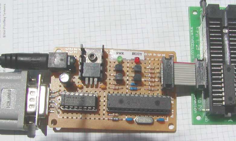

Your bootloader installed 877A's won't work... You need to install the Microchip ICD2 bootloader with a conventional programmer... After that, MPLAB downloads the appropriate firmware into the 877A each time you change projects and target devices in MPLAB...
I would be happy to post you an 876A or 877A with ICD2 bootloader code installed if you think you'd like to try building one (my home brew serial ICD2 clone pictured below)...
Good luck... Happy Holidays... Regards, Mike

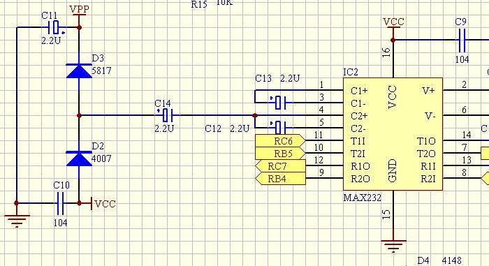

Also, for my ICD2 clone, is it very important that I have an exact 13V source for VPP?

"Also, for my ICD2 clone, is it very important that I have an exact 13V source for VPP?"
Well, it's not that important. But try to be as close as possible.
I guess there're different types of ICD clones.Mine uses the MAX232's voltage booster to provide the system with Vpp,so there's no need to take care of Vpp any more.Which version of ICD2 did you choose,Jeff?

What VPP voltage did you end up with?
Regards, Mike
Regards, Mike
Hi Mike,the result is here:
Target Vdd 5.00V
Target Vpp 13.42V
MPLAB ICD 2Vpp 13.58V
Ah!I got it.Here's the schematic I got from the guy who designed the ICD2 clone I have in hand.The Vpp is generated by a step-up booster.I don't know whether there's any similar design over the web.
Regards, Alex

Thanks Alex,
That's a pretty clever circuit and would be great for a single voltage supply...

Cool, now I dont have to hunt down a transformer that could give me the 13V.
