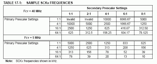

I was wanting to shift a 40Mbps datastream out a dsPIC30/33, clock is not required. I was thinking of using either a) SPI @40MHz, or b) 2x SPI@20MHz using SCLK to MUX the data into single 40MHz stream. I don't need the clock or receive lines externally otherwise.
The datasheets for the dsPICs I looked at specify a maximum 10MHz SCLK frequency. Does anyone know why this is? Or whether it will still function? I was guessing received data may become corrupt at the higher frequencies, or the output driver current consumption might increase...
Any info anyone has on operating the dsPIC SPI at these higher frequencies would be most welcome.
Thanks!

I'm not sure what you're referring to. The dsPIC33F can have a 40MHz instruction clock. The SPI clock can be as high as the instruction clock, but for some reason(s) may not exceed 10MHz (according to the datasheet, also see attached image). I was wondering what sets this limit - e.g. output driver current increases excessively above 10MHz, e.g. inability to clock in data at higher rate, etc. I was also wondering if the SPI module set as Master can output data on the MOSI pin (ignoring or disabling SCK & MISO).

I'm not interfacing to an SPI device and consequently the clock and MISO pins are of no concern to me.

I told you dougy, it's limited by the synchronization of the SPI peripheral to the PIC's clock rate, obviously it can't have an SPI clock equivilent to the PIC clock or it wouldn't specifically state that it can't in the PDF. It's a limitation of the SPI hardware itself an there's nothing you can do about it.
If you're not interfacing with an SPI device then WHY are you using the SPI hardware? Bit bang the I/O lines. Apparently the PIC32's hardware SPI is slightly better as it can receive at up to 1/2 the system clock.
...obviously it can't have an SPI clock equivilent to the PIC clock or it wouldn't specifically state that it can't in the PDF.
The SPI clock frequency can be equal to the instruction clock for any instruction clock up to 10MHz.
Probably. I was kind of hoping that the limitation would be on parts of the module that I wasn't thinking of using (SCK & SDI); it may not be the case however.
