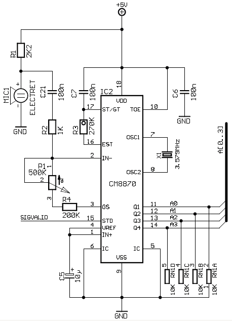

check out the CM8870. It's a full DTMF decoder with AF input via electret microphone.
Adjust AF amplification with P1. Pin15 (STD=Delayed Steering Output) goes high when a valid signal (SIGVALID) has been received, and serves as signal to read Q1 to Q4 (A0 to A3).
Boncuk
Pin15 goes high if a valid DTMF-tone combination has been received. RN1 is a four resistor array with a common ground pin meant as pull down resistor for the outputs Q1 through Q4 (A0 .. A3). Q1 .. Q4 are binary coded outputs with Q1 being the LSB.
Please download the data sheet and study it carefully. It also contains a look up table for binary outputs according to frequencies generated by DTMF devices.
Other than binary values the CM8870 decodes a 'Zero' being "0000", instead of "1010", provided by a binary coded switch.
So if you want to create a DTMF-lock don't use 'Zero'.

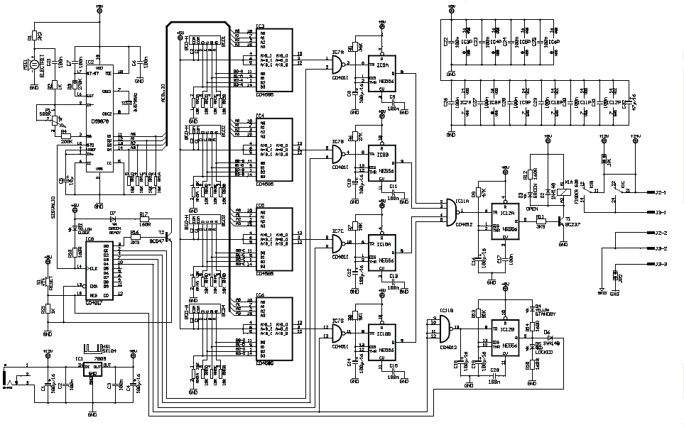

i am interfacing dtmf 8870 with p89v51rd2, Need help with mt8870DE in myanmar-edited-ckt..png circuit attached
i am not getting desired led outputs by connecting nokia phone
please help
RD pin of 8051 to be connected????

How exactly are you getting the tones to the decoder. The drawing really does not show that part. What exactly happens with the LEDs?

LEDs connected on o/p of dtmf
On reset - 0110
On pressing 1- 1000
on pressing keys leds glow for some time and again reset (0110)
even 8051 not responding
please check code

I suggest you run a thread in the uC section of the forums for the code. Once the code is known to be good, then we can focus on the actual electronics. I just really suck at code.
Ron
The hardware to the tone decoder and tone decoder look OK to me.
