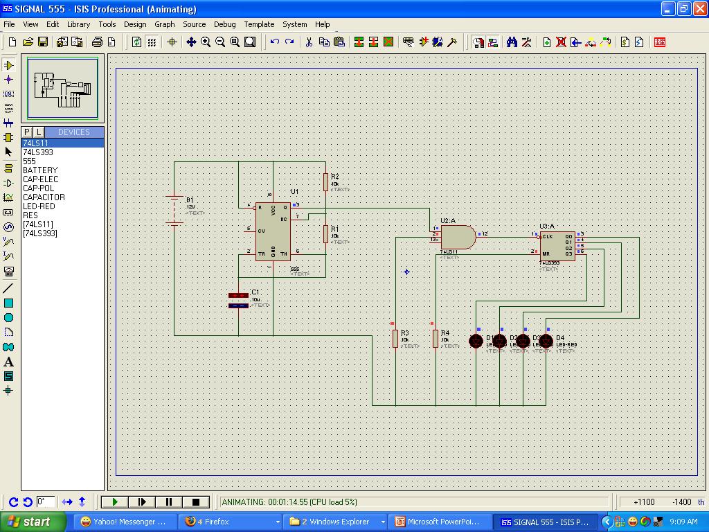

can anyone explain me what is dual 4-bit binary counter..what it is use for? where we can apply it?
my teacher ask me to design a circuit using 555, 74LS11, & 74LS393..
the circuit show us how dual 4 bit binary counter works by seeing the LED..
I try to design it using the ISIS PROTEUS software..but it doesn't work..can anyone help me?

A dual 4-bit binary counter.
Dual means that there are two(2) binary counters each of which is four bits long.

In the attached diagram you have unused inputs of an AND gate connected to GND - they should be connected to +V. You could also just connect them all together and to the 555.
What's the purpose of that NAND gate?
All it's doing is acting as a buffer and the 555 is more than capable of driving the counter so it can be omitted altogether.

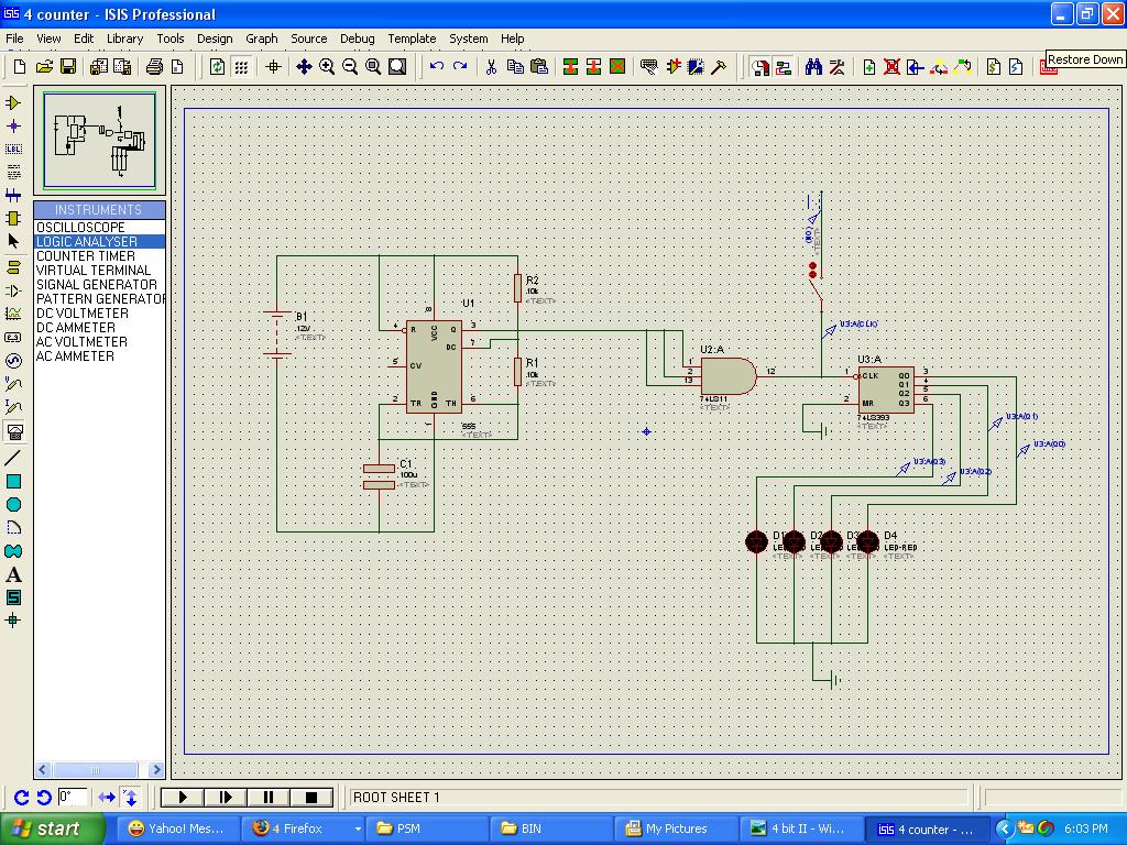

ok i connect all the input of AND gate to the 555 & i do some modify to circuit..
the LED is on..and its start counter..from 0000-1111
1st and 2nd cycle it count properly..but when the 3rd cycle the simulation is failed...why?

You don't need the AND gate, read my post above.
ok..now i want to change the 555 to crystal 80Mhz..& the 74LS393 to 74HC393..because i am doing fast circuitry..
