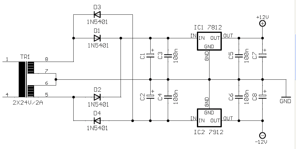

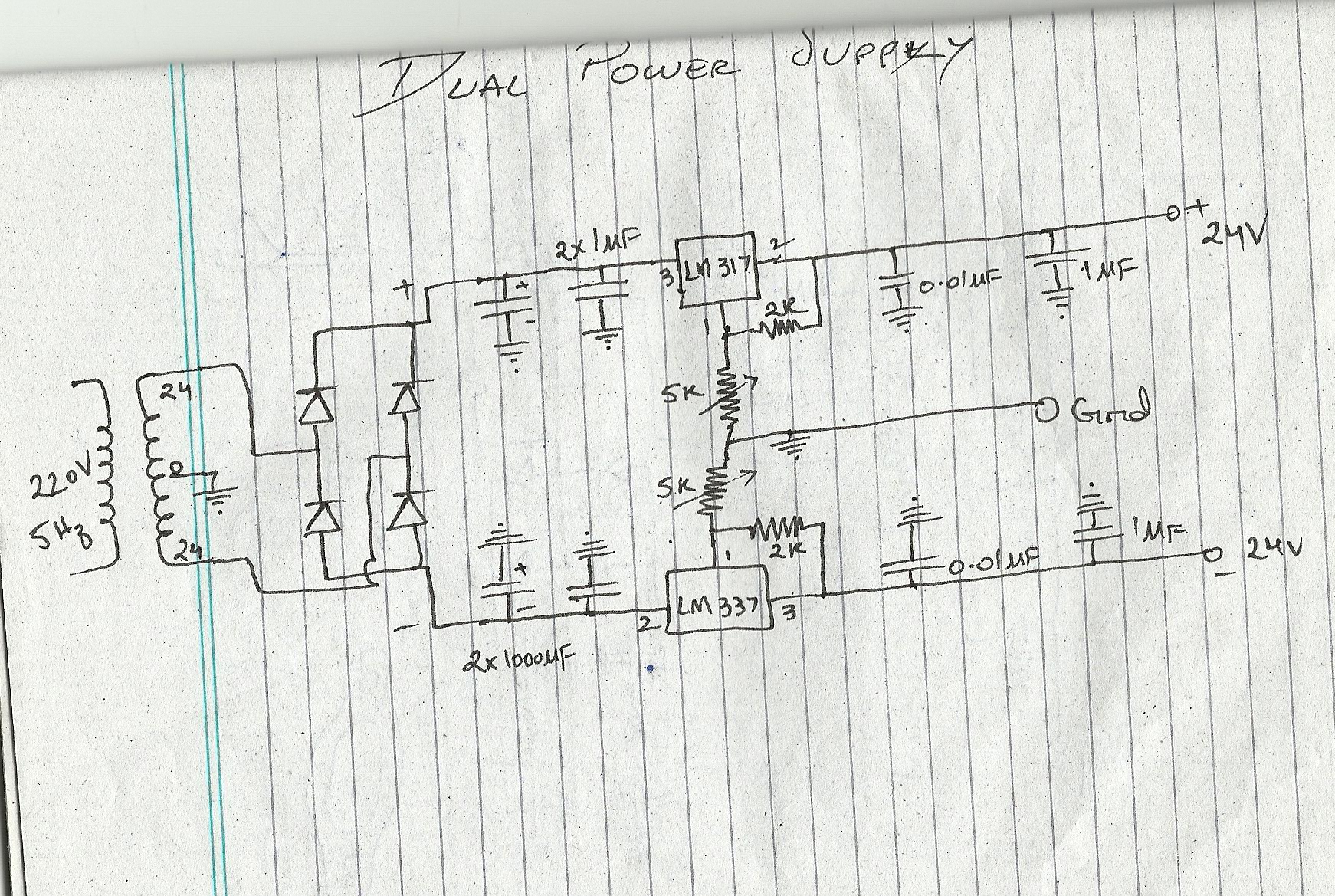

I am using center tapped transformer for making dual power supply ,transformer is of 24-0-24 2 amp . but the problem is that m not getting supply of +24 and -24 instead m getting +12 n -12 volt
Any idea???????:confused::confused::confused:
I you post a schematic we can help you better.
I guess you used bridge rectifiers both outer taps to the center tap.
You must use two-way rectification to gain ±24V.
Here is the schematic, using linear voltage regulators. The inputs are connected to 24V rectified positive and negative rails.
The center tap is used for common ground.

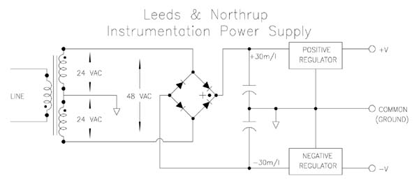

Schematic is the standard circuit used for Leeds & Northrup for instrumentation.
You may need more varied capacitors to catch spikes, depending on the application. This is just the basic filtered circuit.

yes my circuit includes bridge rectifier ..Im using the same schematic buddy... and using LM317 and LM337 for positive and negative regulator... and i have 24-0-24 volt transformer but why it is giving +12 -12 volt output. or this circuit gives half input 24 to 12 volt...
The unregulated voltages at the inputs of the regulators should be +33V and -33V.
The 2k resistors on the regulators are supposed to be 120 ohms or less. Then when the 5k pots are set at max resistance the outputs of the regulators will try to go to 53.3V but then the regulators will not regulate.
If the resistor is 100 ohms and the pot is 2k ohms then the max output will be 26.25V.
Thanks sir, can I ask you something. that how do you know that it is +33v at input?,yes it was near 33. and please tell me , why it won't regulate at 53.3V ....
24 *sqr2 ~ 33.
The LM317 can regulate up to 40V (max.) difference between input and output.
Of course the input voltage must be higher than the output voltage.
To get to 53.3V out of 24V (33) you need a step up converter. Also at 53.3 you can't get the chip to regulate to 12V, since the input to output difference exceeds the maximum allowable value of 40.
