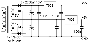

I need to make a power supply tha can make a 5 volts and 9 volts output... any good ideas guys?
Here is a simple solution....
