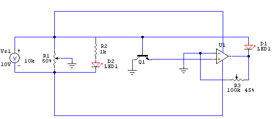

here it is all of it!
here is all the project
well as you can read i am a newbie! so no laughing ok?!
it is simple light detector which will light a led (D1) when the light beam between the red led (D2) and sensor (Q1) is cutten.
NOTE: that Q1 is not a transistor i just did not find anything else in the drawing software [actually it is the sensor found in all old computer mouse, I apply a voltage on 2 leads and i get an output voltage if there is an infrared light striking it. Red led simply does the job of emmiting infra red light very fine!]
So when voltage divider R1 is at center position, all my output will be delayed by about 0.5 a second, from the time an input change was applied.
BUT: when i adjust R1 so that (+V = 0.2 v) and (-V= 9.8 v) the whole thing works very fine with no delays at all, and in both 2 position:
- D1 glow when light does not strike the sendor
- or D1 glow when strike the sensor
which i adjust by inversing D1 and connecting it to -V
so .. does anybody understand ??

Well I'm rather baffled by the circuit, but one obvious mistake jumps out and grabs me! - you don't have a series resistor with the LED - that's certainly likely to upset your dual-rail supply. Also I'm bemused by the way the inverting input of the opamp is connected?.

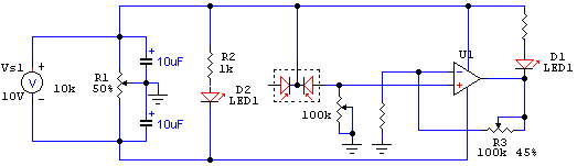

Some thoughts:
definitely need two decoupling caps (10uF) and connecting the pot wiper to end. A resistor need from inverting input (-) to GND, because the feedback not working...
The canibalized part from mouse a dual photodiode, show me Your connection in circuit.
And what is the function of circuit? What is the end-application?

wow... thanks very much.. i really appreciate giving this precious effort.. really thank you...i was allways wondering what is the sensor from the mouse.. now i know it is a dual photodiode... gr8! :D

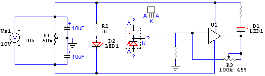

well here is what you asked, my connexions in the circuit... i know it looks strange but this exactly how it is connected in my circuit...
Actually there is no specific end application, it is many done just to learn .. i am an absolute beginner... :oops: but i think it can be used in alarm systems by connecting the output to the trigger of a monostable timer that outputs a voltage to a buzzer ..for example!

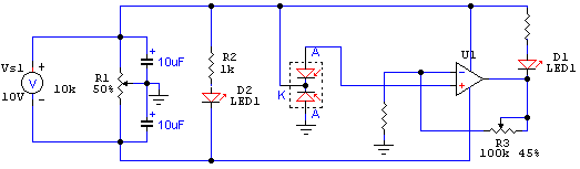

hey hey hey..i thought about something.. tell me if am wrong.. can't the slow response of the output be caused by the slow response of the led which shows me the output ???
O.K. You need only a half section and a bias pot.

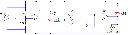

Don't fart around with adjusting resistors. You need an op amp to create a stable artificial ground that doesn't "move around" as you play with the circuit. The only limitation is that the difference in the currents between the "new" positive and negative supplies can't exceed the output current capabilities of the "ground" op amp. You might want to add capacitors between the two supplies and ground. Don't put capacitors across either of the 100k resistors - it will make things worse.

I have re-posted the schematic of the circuit with the buffered ground below.
