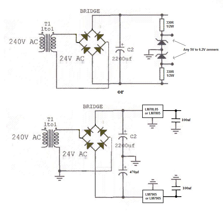

If the circuit dos not do what I require then could you modify the circuit with the -6and +6 voltage rail ( which is taken from the 24V DC supply )and post it for me.

I don't see any reason why you can't generate the +-V supply from the 24V supply on your transformer. The circuits attached will work, the first uses zenners and can supply about 30mA, so it might not work for your relay uses more than 8mA, the second uses regulator ICs. You could also use bufferd zenners, like the one in your 3V supply, but you'll need a PNP trnasistor for the negitivce supply.

hero999,
You might want to rearrange the diodes or you'll let the smoke out. ;)

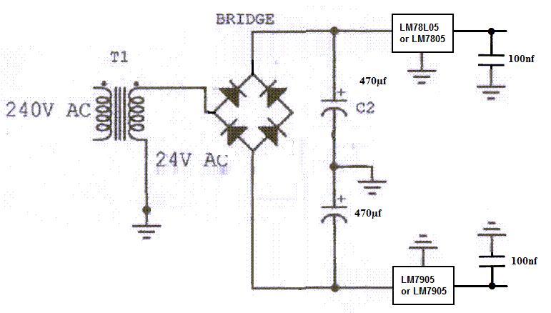

It would be even better if he had a center tap on his transformer, but something like this will work ok:

Corrected, sorry I should've read the whole thread first and even if I didn't I still should've noticed.
Note also that both C2 and the capacitor I added should both be rated to 35V.
