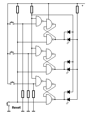

I'm after a circuit for three quiz contestents. The first person to press their button, after a question is asked, their light will light up.
The judge can then resett the light(turn it off).
How do I do this without using a pic (Non Pic programer)?
thanks
Do You like this?
