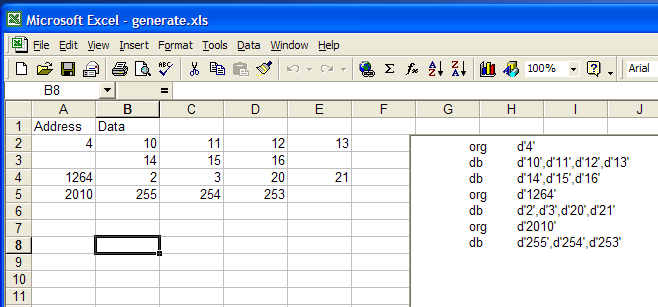

If you can post an example of the data then it would be easy to turn it into an asm file that MPLAB can turn into a hex file.
My data
I plan to burn something like this: (all decimal notation)
At address 0004 => 10, 11, 12, 13, 14, 15, 16
At address 1264 => 2, 3, 20, 21
At address 2010 => 255, 254, 253
and so on...
See the attached excel sheet. Is this what you mean? It takes the data on the left and converts it to the asm on the right (see image).
At the end of the code (press alt-F11 to view) there's 4 commented lines that will write an asm file out.

Got my hex in Intel format.
Gracias Mike. With your VB + Excel and MPLAB I got the data in Intel format.
Just a clerical detail: I need to move the white panel in the Excel file (the one showing the file being generated). It is hiding part of the cells I am typing in. How could I move it?
With your help, things were much easier than what I feared!! Gracias again.:)
To move the panel,
Right click on the toolbar and turn on the Visual Basic toolbar,
On the VB toolbar click on the icon with a set square and pencil (design mode),
Move the text box,
Click on the set square again to make excel normal again.
