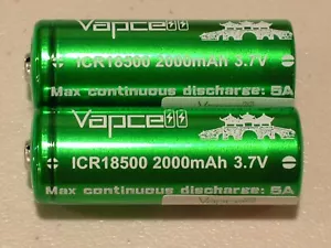

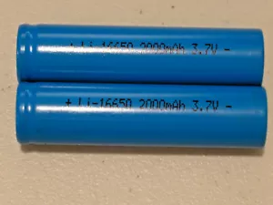

The attachments show many No-Name-Brand batteries probably made "over there" in somebody's basement and are sold to Vapers.
google shoes many articles and videos about fake or counterfeit 18650 battery cells mostly full of flour.
