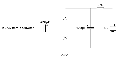

Going on my assumption that it's AC not DC, here's how I'd do it.
It won't work if it's DC.
I suggest you measure the output voltage from the generator.
Fortunately, it won't do any harm, if it's DC the battery will just fail to charge.
The circuit will be much more complicated, if the voltage is 12VDC.
I think you should make sure you know whether it's AC or DC first.
If you're not sure, connect two LEDs in reverse parallel with a 470R resistor in series and connect it to the output of the generator. If it's DC only one LED will glow, if it's AC they'll both glow.

A DC motor will output DC and a stepper motor will output AC.
The motor will need to output a higher voltage than the battery plus a diode drop, to charge the battery.
Assuming I use a bipolar stepper that outputs 3vac, would the circuit you posted earlier on charge a 9vdc batt, if not, what can I do?
Then you'll need a voltage quadrupler to charge the battery and it presumably needs to be be multiphase too.
It's easier to use a 6VAC generator.
