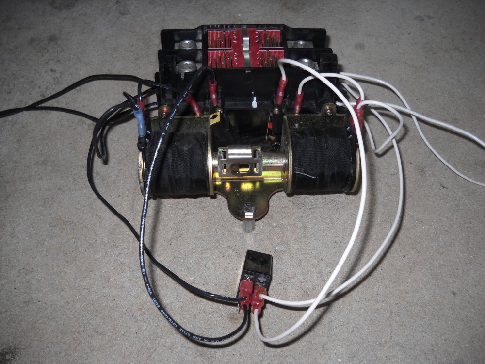

Thank you for your reply. Right now we have a circuit breaker system that looks like it should be installed in a home. To the main in switch, there are two e-stops connected. When the e-stops are pushed, a fourth breaker which is latched in with the main three phases is tripped, which causes the main three phase to trip also. However, we are completely redesigning the control system, integrating a more professional system, with the din rail mini breakers and disconnect switch.
I did a little research on the three phase contactor with push button operation, and I found a few things like this:
Is this what you were talking about? It's a simple and elegant solution. Thank you, I hadn't come across this. However, it looks like it's only going to work for one e-stop button. I was needing one at either end of the machine. If we wire two N.O. P.B. to the N.O. auxiliary circuit, in parallel, we would only achieve the stop by pushing both buttons.
Or, as far as I can see anyway. Like I said, I'm a definite green horn in this. Do you see a way I'm not seeing to hook up two estops with this or any other application you may have come across?

If you use a NC E-Stop and wire it in series you can have E-stops on either end of the machine. Once the switch is punched it will open the circuit and stop the machine.
Yes the E-stop string is all device,s AND'ed, i.e. in series, this can include any O.T. limit switches e-stop P.B.'s, or? etc .
The final device is the E-stop relay where a relay contact would also control the coil supply for any relevant contactors, another contact could advise, say, an operator panel that a E-Stop had occurred .
You can get E-stop P.B. that stays in when pushed with twist turn to reset, but I prefer the momentary P.B. with the system start P.B. there are a few examples in the Telemecanique wiring examples.
To take it further you could look into Safety Relays, they come in different configurations, for e.g. time delys included for staggered shut down etc, these are slowly becoming mandatory in N.A., they have been in use for some years in Europe.
