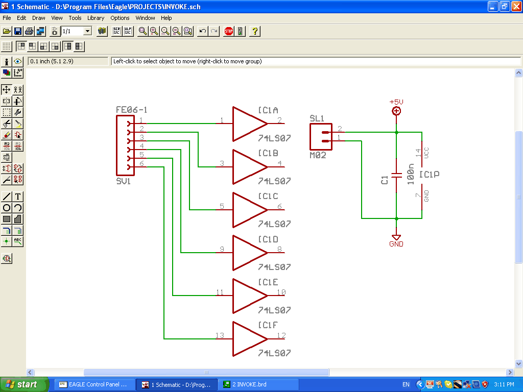

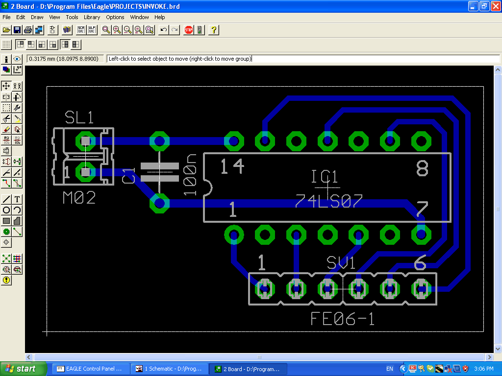

Hi Mike,
here is a small circuit with the power pins of the IC invoked.

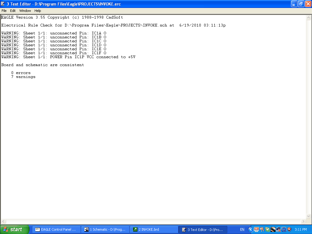

Notice the ERC warning. Instead of connecting pin14 to VCC I used +5V. Pin7 is connected to ground as the pin name suggests. Connecting it to VSS you'll get one more warning.
Please note that the DRC also warns about unconnected output pins.
