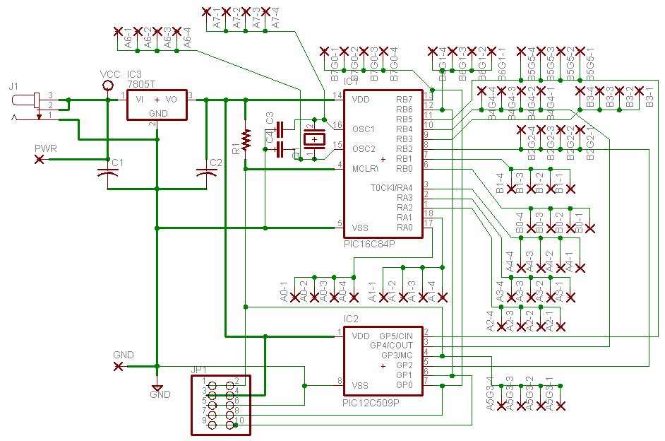

Bill (Blue room) got be all excites about the blackfly, I figured I would make a 18 or 8 pin PIC board to proto on. Just really learing eagle cad.
I dropped a 2x5 connector and it will not connect the pics to the connector
in the PCB mode? Any ideas?
EDIT: moved schematic to the end of this thread (corrected) saved some disk space.
in the PCB mode?

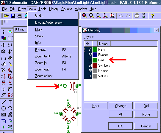

You need to do this in Schematic mode. Once you enable the PINS layer, (I don't know why this isn't the default :rolleyes: ) it will be easier to snap the Nets (connecting conductors) to the components. See attachment as per justDIYs post:
Thanks JustDIY and kchriste.
I just did not hit the little marks. Good to know about "pins". Learn about turning off routing lines today as well.
I figured single layer out as well. 1 = * and 16 = N/A. And save it for future boards.
I had a couple major error I fixed as well. Since I lined up all the port pins (GPIO to RB), then added ICD connector and short 2 of them to each other. (RB6 and RB7) :)
Triyng to get a single sided, 8/18 pin pic board with small proto area. For quick projects. ICD on the 18F88 and a programmer if nothing else.
My Grandfather is going to look at making it single sided. He no longer has Orcad, but pulled Eagle. He is a quick learner.
I made three tries at it, closer I came the worse the jumpers became. 3 jumpers, but they were jumper wires not 0 ohm resistors.

Did you design this connector schematic symbol/layout yourself, or was it a premade one? this kind of problem is common when you design the part with a different layout grid than the schematic you're trying to use it in. For instance, in schematics, you're usually using 0.1" grid and all your wires are snapped to it. If your part was designed with a smaller grid and then the finished symbol wasn't placed such that all the pins fell on the points of the default 0.1" grid, you get the type of problem you are experiencing, where the wires and the pads don't line up.
When I design the schematic symbols for new custom parts, I usually set the grid to 0.0125" (which is 1/8 of 0.1") and then set the "multiple" property to 8, so that the grid that gets displayed is 0.1", but I can still draw and position things on the finer 0.0125" grid; and then I can very easily make sure that I get all the connection points placed directly on the junctions of the 0.1" grid so I won't have any issues using them in schematics with default grid sizes.

One thing you should do in the schematic editor is always keep the grid on .1" grid. Otherwise, you can't hook things up. It looks like that is what happened here. I use an alt-grid of .025" for moving names and values around but never do that for components.
I keep it at .1". Also, I hold ALT when I move the text and some lines, never on the parts. The ALT lets me move the text were I need it in PCB in smaller increments.
The problem was, I did not hit the pins in the right place, just adding it last minute in a hurry.
Going to lay this version out today. Sort of a quick project board.
