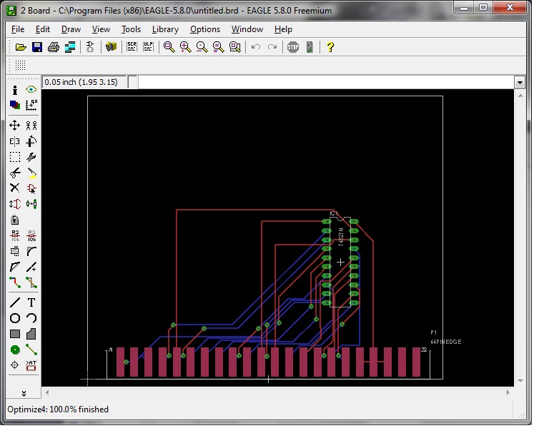

I have created an edge connector package (I used a modified copy of an existing edge connector library) which has a problem: the connection point seems to be in the middle of the connector pads. Auto will connect between the pads and will place vias between the pads. I need the connection point to be on the inner-most edge of the edge connector finger pads, not the middle. Any way to do this?
I can move the vias and wires after Auto routes them, but it's a lot of work and isn't as clean. I have tried adding pads and holes at the back of the finger pads, but auto seems to ignore them and persists on keeping the starting point in the middle of the pad.

I realized from your explanation that you are just trying to move the traces to the correct position afterward. For a clean routing, you should be ripping up the traces that aren't routed the way you like then replacing them. You don't need to rip up the whole trace, just far enough back from the pad to do a proper route. Route starting from the pad in order to have the trace centered on the pads origin.

I have attached an example (two sided board with edge connector). Note the traces and vias between the edge connector fingers. Even if I route manually, it still wants to start the trace at the center of the pad. I have tried playing with the Net Classes Design Rules with out much success.

Hi computerexpert,
when routing a board containing pads (most probably metric pad spacing) you should use a finer grid, e.g. 0.0125inches (presently used 0.05inches).
If that won't suffice reduce grid size to 0.00625inches. Don't use a pure metric grid since you will run into problems with the inch-based IC.
Traces will be straight out of the pad and you can move the vias outside the connector.
It will require quite some time to route satisfactorily, but as already mentioned by Mark you might rip up single traces and reroute manually.
BTW, the autorouter won't do a thing at grid sizes smaller than 1/160inch.
I suggest to start routing from two pads and end the trace temporarily somewhere on the board. Then pick either end of the trace and continue routing until traces meet (on grid).
