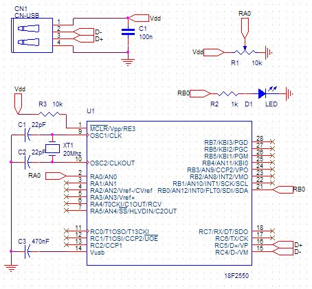

Hi i have included the schematic of a pic USB device, that i found on the internet.
Can someone tell me how the author has managed to isolate the different components of his circuit, i.e wires do not directly connect pic>d+ to usb>d+.
Many thanks

look at net name.. if they are the same, then they are electrically connected no matter what the schematic looks like.
If I understood the question.
On the schematic:
All wires with the same name are connectect together, but the wires between them are not shown.
the D+ wires on the USB connector and the PIC both have the same name. When you layout the board the airewires/rubber_bands will be there to ensure you make the connection.
The tag things with signal names generaly indicate that this is the case.
This makes for a much easier to read schematic.
Perhaps it is called detached drawing of a schematic.
this technique was followed in telecom since log time
I've been using that style more and more recently, it makes for a much cleaner and compact schematic... clear and concise labels are a lot easier to follow then trying to follow signal wires (all of which are the same color) around on a diagram.
another useful eagle feature is the BUS command, you can define a bus to carry multiple signals, represented by a single fat line ... connecting two or from this bus brings up a menu prompting what signal you want to connect to.
the only thing I'd like to see is the ability to color code the bus 'wires', if you have to buses on the same schematic, it would be nice to have them different colors, in addition to having them labeled.
