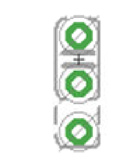

To allow for caps of different pitch, there are some footprint in (I believe) the RCL library. You have to connect the 2 common pads together yourself. Here's a pic of the pattern I often use.
I'm short on time this morning, but I'll look up which library this is from later if you can't find it.
Yes I have it, but it took a bit of grey hair to find out I had to use "append" in the "device package connect" part.
