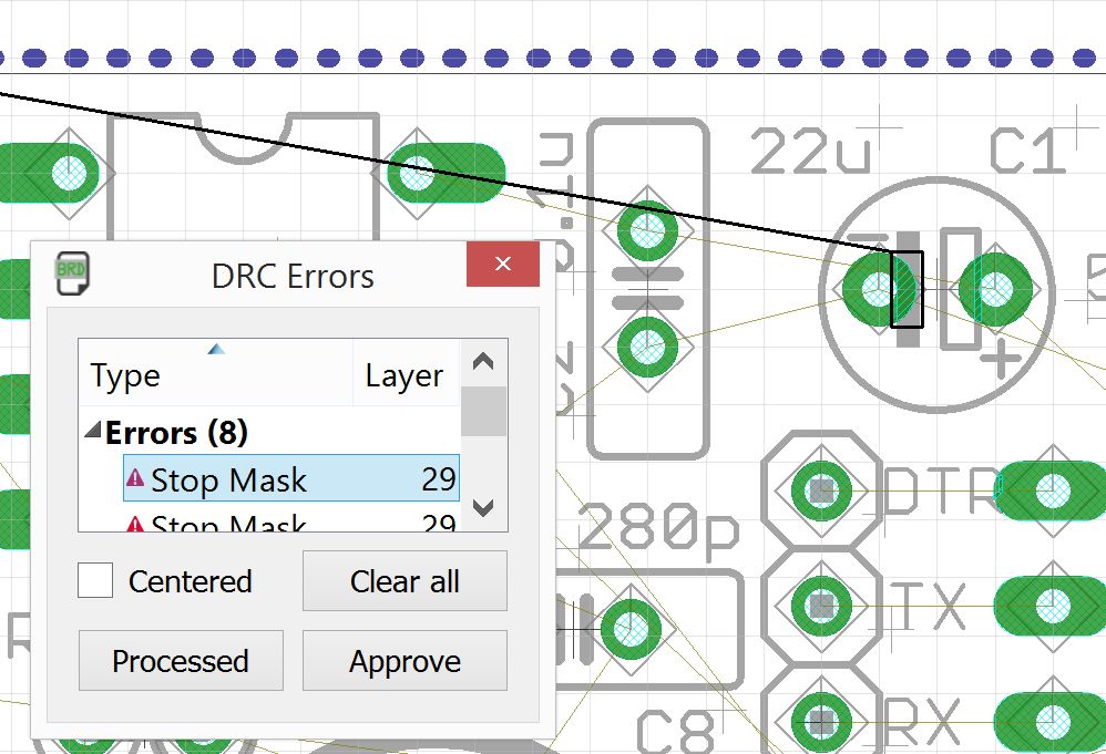

Out of the blue after multiple checks, and with always .sch and .brd open at the same time I get these "Stop Mask" errors where funny little marks appear in the stop mask (top and bottom) of several components leading to these errors.
These marks are not present in the part in the library and only appear after a DRC is done on the newly opened file.
Would anyone please want to have a look at this? I am baffled.

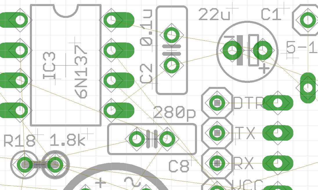

I've never seen that error before. Some quick looking shows the error occurs any place the silk screen layer intersects holes (i.e., pads) in the soldermask. This isn't a problem for making a successful board, as issues like this get taken care of in the process - you'll never see silkscreen across a pad, but it will affect how the board looks - Read an important comment below.
This illustration shows one of the errors.
One this to note in this illustration - the blue cross-hatching is the Tstop layer. "Fixing" these errors is pretty simple. Don't display the Tstop and Bstop layers. This is why I've never seen it before. The illustration below shows the same area with the Tstop layer turned off - no more errors.

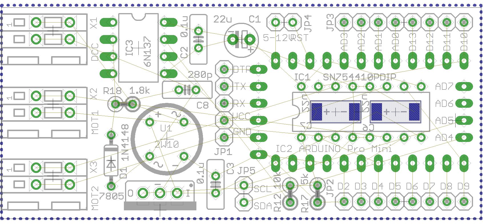

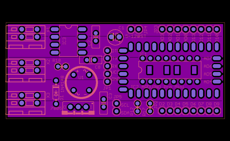

Hmmm... maybe this has been fixed in version 7. The picture below is the board as it looks in Eagle. The second is the Gerber silkscreen layer.

When you turn a layer "off", you're only controlling whether you see it on the screen. When I opened your bed file, every layer was turned on...maybe you toggled all layers on to cause this "error" to show up. I used the default DRC and I saw only about 5 errors, which all went away when the tStop layer was off.

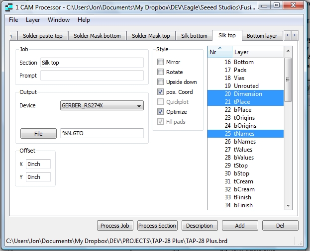

To include values in the silkscreen layer, you need to enable the tValues layer in the silkscreen layer in the Gerber CAM job. Whatever layers are ticked will be included in the Gerber layer. I'll post a picture shortly.

So, sober again, and I just converted all text to vector, problem solved except for 3 obvious stop mask errors: the ones JonSea did show in post 2.
