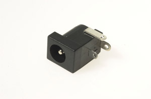

concurrently, i queried earlier with golden phoenix and they hv problems with my dimensions needed for slots for my dc power jack and slide switch. For milling, they need X (A.N.D) Y size>than 1.5mm. The one I am using is attached. Any thots?
I have not decided on AC or GP, but thought I get all my grounds covered. Thks!

any tip/recommendations for the slot 'problem' I mentioned earlier? Thks!
