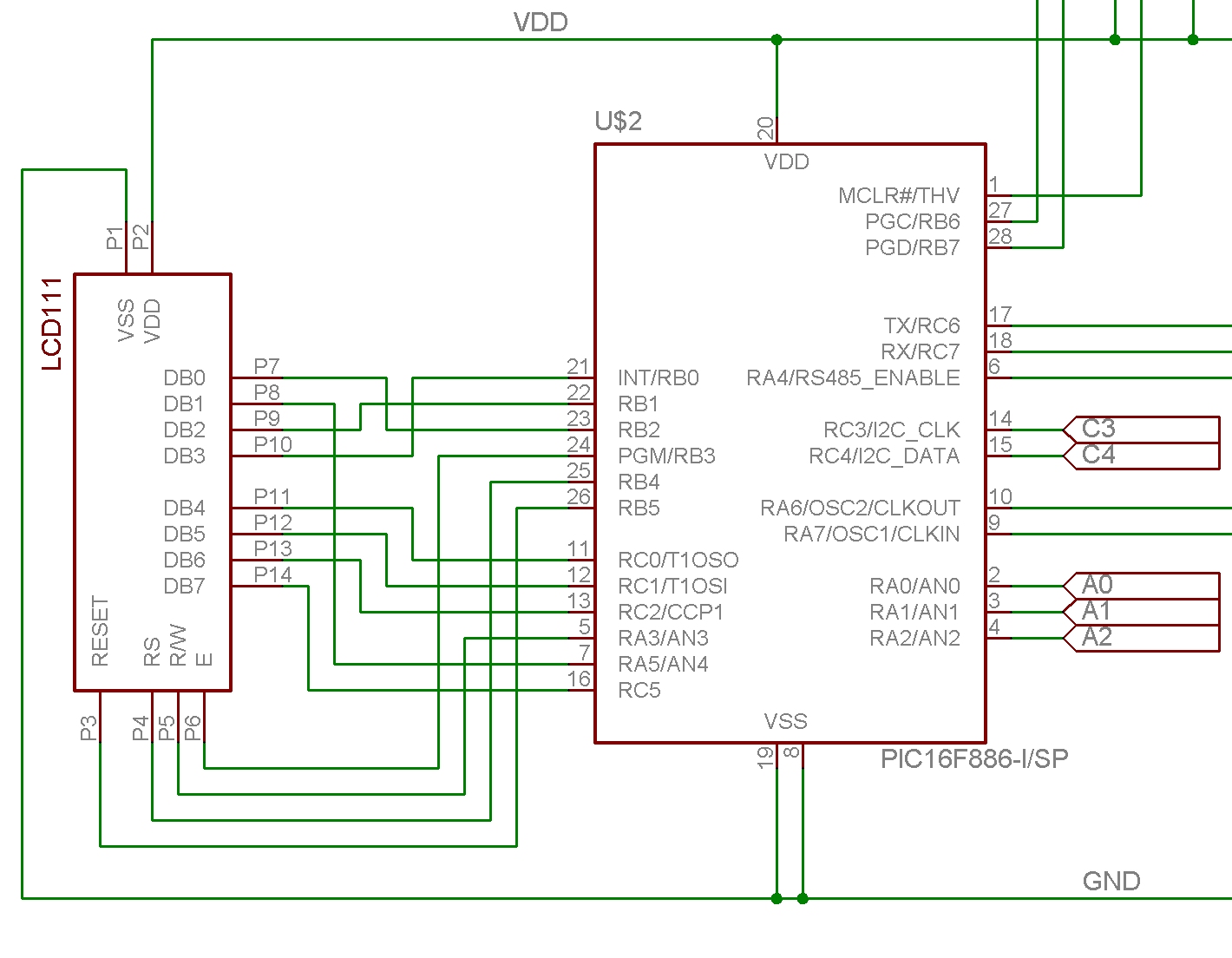

Good idea. You can also make a symbol with a pin arrangement that works best for the schematic you are working on. A view of the chip as you are using it.
The attached example shows a PIC16F886 where I grouped the pins used for a 8 bit LCD on one side. It makes for a much neater schematic. Perhaps a bit anal but why not strut your stuff.
EDIT: The PIC to LCD pin assignments were made to reduce the number of vias on the board. It makes the LCD driver code a bit interesting but you only have to write it once.

3v0 what are you doing? why are you using so many pins to control an LCD? you only need the first 4 bits of the LCD control unit. all the libraries have been written that way and most of the commercial applications are done so. no-one uses 8 bit data on character LCDs anymore ;). and then you can fit the whole LCD into one port of the PIC wasting much less pins.
connection like that: http://www.oopic.com/lcd.gif
a little OT, but i just had to say that ans save you a lot of trouble hopefully.

The point of my post was to show that you could create Eagle symbols that make you schematic easier to read. It was not about the circuit which I think I have talked about in another post.
This is a general purpose controller with a few IO bits and a $1.50 LCD display hardwired for a 8 bit parallel data bus. Using a 28 pin PIC reduces the part count. The board is the same lenght as the LCD which can be mounted with angle brackets.
