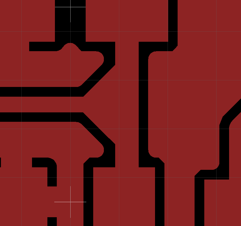

I need my 90'degree joints to be filled like a triangle as in the 2nd image.
When I use polygon tool + Ratnest its endup like the 1st image.
I need nice joints.How to do that?

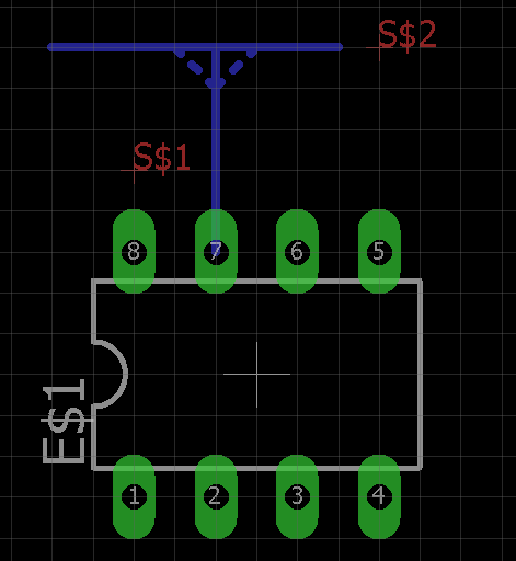

Here how I did.
1. Using Wire tool draw two wires to make a T joint.
2. The default wires names are attached in the picture.
3. Using polygon tool draw a triangle over the joint.
4. Using the Name tool change the polygon name to “S$2”.
5. Click Ratnest.
6. Nothing happened the triangle still like earlier :(

I think I use my T joints using just a Wire tool.In this case renaming the polygons not working.
Making a T joint using a Signal tool & Routing its working.

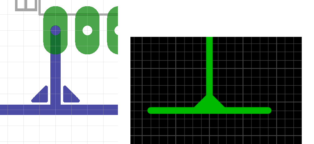

Works for me:
The trace for which I did the triangle fill is 0.016". Sorry for such a large image.
You must have a setting wrong.

Suraj143 Are you sure S$2 is the net name of the tracks in the T-junction?
