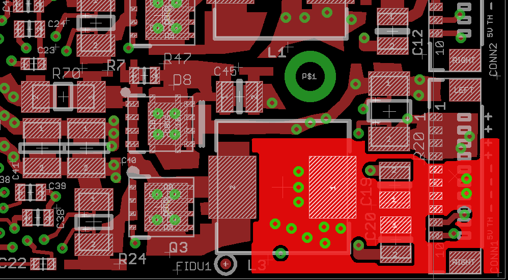

I redid net N$29 in just a couple of mouse clicks.
Using a simple polygon:
Set: Layer = top, width= something very small
There is a small window at the top where you can type in commands: POLYGON N$29
Draw a rectangle. It should be red dotted lines. The click on RATSNEST button.

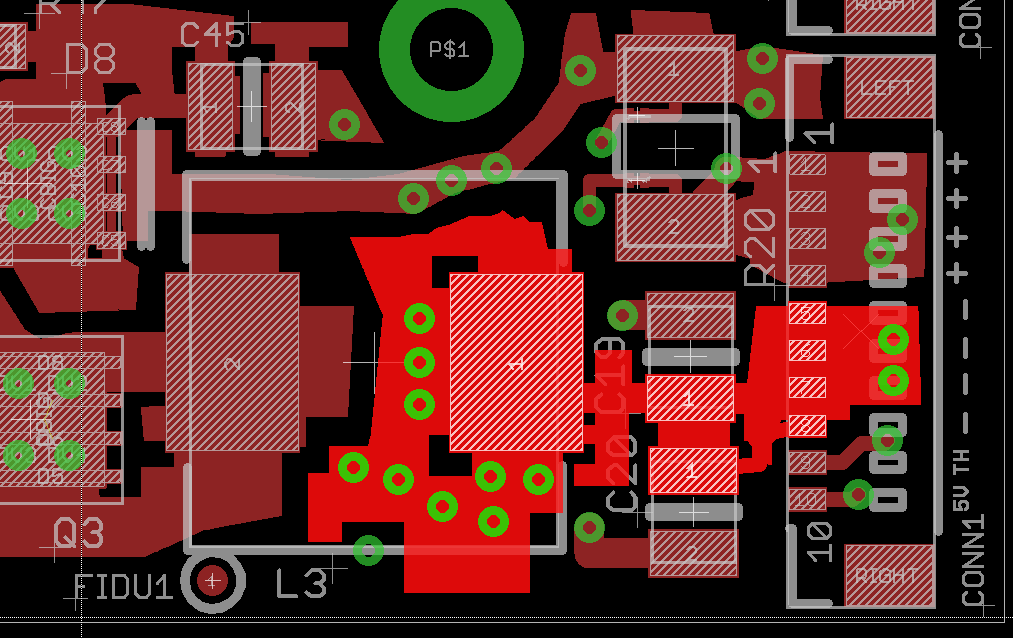

The polygon bled into net N$26. (not good) So INFO button. Clock on the edge of the polygon you drew. Down to PROPERTIES. Un-select THERMALS, and set RANK=6.
>>The RANK=6 means that all other POLYGONS will cut into it.
What I often do is make a GROUND polygon that covers the entire board on one or more layers. Rank=6, and thermals=off.
Then make some small power polygons with a rank of 5. Then some wide areas for high current with a rank of 3.
Now lay down the traces that will eat their way through the polygons.

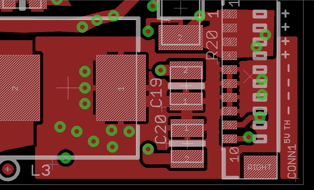

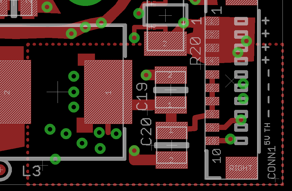

Here is the polygon. In this mode you can see through it.
Note I plowed though other polygon. I also went out to the edge of the board.
Now I pushed the RATSNEST button.
Note the copper does not go to the edge of the board and the other polygon cuts into this polygon.
NOW THE REAL QUESTION: How do you get back to the "clear" looking polygon? You might need to see through the polygon to rout traces.
ANSWER: I don't know how. There must be a easy way. I pick up a side or corner of the polygon and move it a small amount and then move it back. Any change will cause it to go clear.

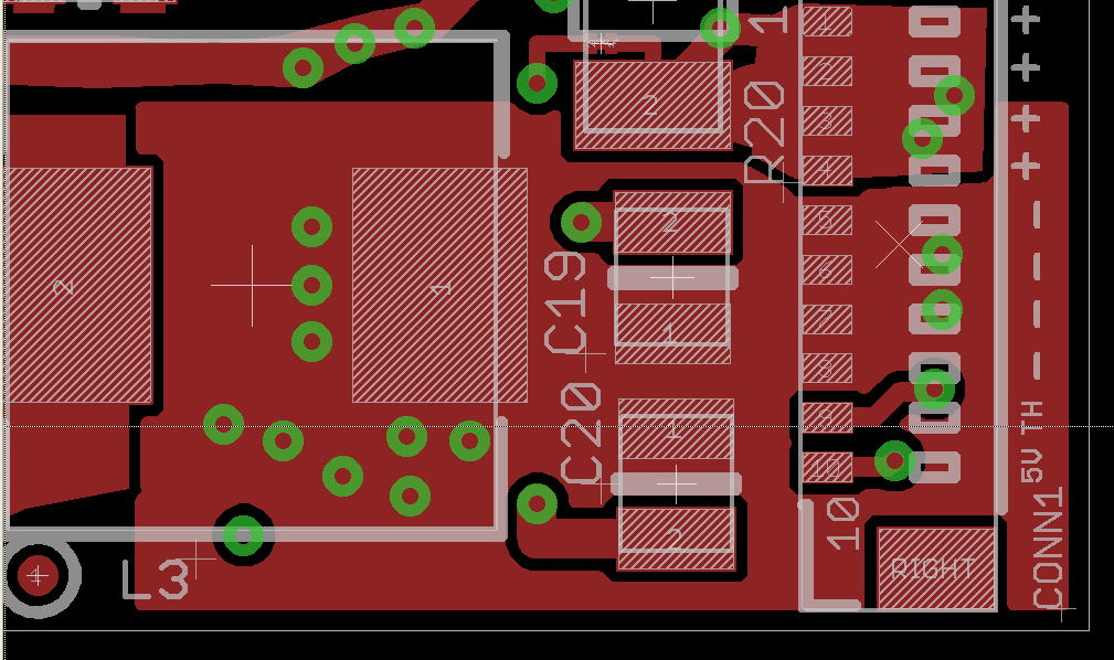

This is what it looks like with THERMALS turned on. I do not do this. I am trying to get the heat from these parts to travel into the copper and be carried away. With the way I solder the parts the thermals do not help.
In some cases you want thermals on for all the little parts but you do not want thermals for the hot transistors and ICs.
Make a polygon with thermals on for the entire area or board. Then make small polygons (the size of the IC or transistor) with the thermal turned off. It is OK to have polygons on top of polygons. By stacking polygons you can have small areas with different effects. (thermals, clearance, line widths, etc)
