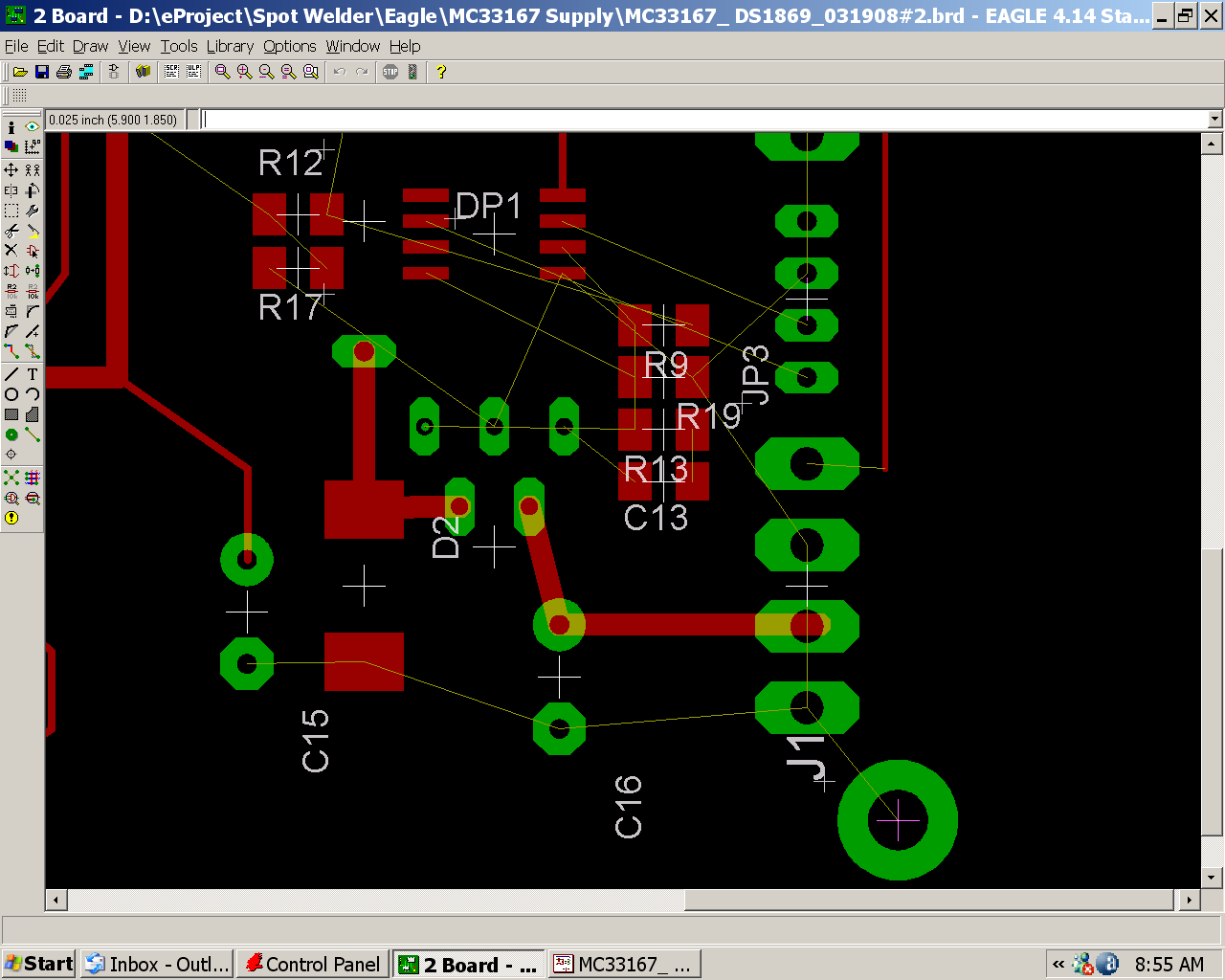

Upon running DRC, I get an error, "layer abuse." Of course, no such term appears in the index nor in the two index items for layer. :(
Here's how I got it. I am routing a single-sided board with SMD devices on top and through-hole devices mounted on the back side with pads on the top. I realize there is an inversion there, but since all of the TH devices have the right plane of symmetry, it is no problem to remember to "flip them" when installing. For example, a TO-220 3-pin device can be shown on the top with the tab on one side and installed from the bottom with the tab on the other side.
The one exception is a 5-pin TO-220 with staggered pins (i.e., case 314B; two pins back, 3 pins forward). That is not symmetrical with respect to the plane of the tab and cannot be flipped and still work.
My solution for routing the board was to label pin 1 with a mark, mirror the device, and install it in the usual manner. The label helps me keep track of the orientation.
When the device is mirrored, EAGLE apparently thinks it goes to the bottom layer, but the pads remain on the top layer and do not have vias inserted by EAGLE, as you would see if you changed the layer of a trace. To further confuse the situation, the layer abuse error occurred for only one pin, not all 5.
Any ideas what the error means? How to avoid it? Etc. One obvious solution is to make a new device with mirrored (and mislabeled) pins, but I would like to avoid that option as I am likely to forget about the changes and get screwed in the future when I use it.
John
Edit: added image. The pin withthe "dot" inside the pad generates the error.
When a device is mirrored it switches layers. Top->Bottom or Bottom->Top.
Route the board with the SMD's on the top layer. Mirror the through hole parts when you place them, to send these component to the bottom side of the board. Through hole parts already have pads on both the top and bottom layers. No need for vias. Both the SMD and the through-hole parts will be soldered on the top layer/foil. There will be no connections to any pads on the bottom layer so you can etch it as a SS board. No need to mount parts weird.
I have never seen the layer abuse error. Would need the version of Eagle and a file to work with.

Check this page:
About halfway down under "DRC Command" it mentions the Layer Abuse message:
DRC command
* The DRC now checks for objects in the Pads and Vias layer that are not Pads or Vias (i.e. wires, rectangles etc.) and flags them as "Layer Abuse" errors. The reason for this is that EAGLE does not handle these object in any special way, so they might cause short circuits. If you get such an error from the DRC, you should move the object in question into the proper signal layer(s).
Does that make any sense with what you have in your Pads or Vias layers? It's not a lot of information but it's a place to start looking, I guess. . .

Both of your comments make great sense.
3v0: I put the "dot" in layer 17 (pads), but clearly, Eagle handles it slightly differently than a pad for connections. It still appears on both layers when I mirror (that's why I used layer 17), but in my version, if I click on information (eye icon) and a pad, I don't get a layer number; my dot returns the layer number.
Torben: I didn't go to the main site. I just went to Help and couldn't find it there. Thanks for taking the time to go to the main site.
As many have noted before me, most of the problems with Eagle are in just knowing where to look. Problem solved.

That is where the problem occurred. The device had 5 pins that were staggered. That is, unlike the typical TO-220 package with three pins in a line and in the same plane, the pins of the 5-pin device were in two parallel planes to the tab. Thus it could not be flipped and rotated to take care of the mirror imaging that occurs on the bottom layer.
As for mirroring discretes, I agree that with two pins, there is never a problem. However, with 3 or more pins, there also is not a problem if the pins are in the same plane, as they usually are with the TO-220 case.
To get the DRC error, you have to modify the package by putting a mark in layer 17 on one of the pads and then connecting to it (see my original post). Torben discovered the explanation on the Cadsoft site.
