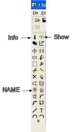

When you connect two or more points you create a net.
Click on the NAME icon then click on each net you want to be GND and name it GND. They becomes part of the GND net. They will all be connected on the board.
Click on the SHOW icon and click on any net named GND and everything that is connected to it should be highlighted.
Use the INFO icon to find the name of any net.

see image above. left column, from botton 4'th. invoke

Click on INVOKE. It is the icon about the T icon. Then click on IC1 and you will be presented with a menu that lets you select the power and gnd. When you do so you will get pwr and gnd pins for IC1 that you can place anywhere on your schematic.
