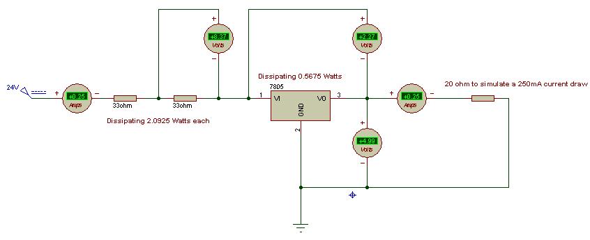

If you could get hold of a 12/15V plug pack, then the 7805 is great, and cheap ($0.25 from www.futurlec.com)
Perhaps use a 5W wire wound resistor available from www.futurlec.com to step down the input voltage
Although rated for 5W, driving them at 2 Watts will still produce a lot of heat, but you can drive your loads up to 300mA dissipating only 1/2 Watt over the 7805 (Power is calculated by V * I)
Using two 33 ohm resistors means that half the heat can be dissipated on each resistor

If your 24V input is reduced to 8V then a 7805 won't need a heatsink since it would dissipate only 660mW. But with 24V as its input it must dissipate 4.2W and need a pretty big heatsink.
