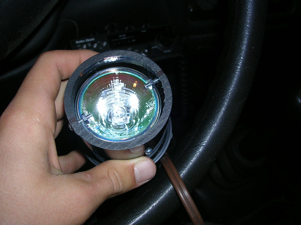

You know the spotlights that cops have on their cars? Well I wanted one :lol:
I bought a 50W halogen light from allelectronics for $2.50: https://www.allelectronics.com/cgi-bin/category.cgi?category=search&item=HLP-503&type=store
I then put it inside of a 2" piece of ABS pipe (because its black :lol: ) you can use PVC too. I also put a 2" cap on the back where I put a panel mount toggle switch and drilled a hole to put a wire through so that I can hook it up to my truck battery. I wanted to put a cigarette lighter plug on the end but I didn't have one. You can see how I held it inside the pipe, with four screws, in a square if you're looking straight on at it. Two to hold the bottom and two to hold the top. I just got to thinking that one way I could've improved the design would be to have a piece of plexiglass on the front holding it in and the two screws on the back but ah well :wink:
It's only about 6" from front to back. It works GREAT! take a look at the photos. I drove by a party and shined it at all the kids, must've gave 'em a bit of a scare :twisted:

Well its not so much the connecting of wires, but how I used the screws to hold it in the pipe and stuff.
