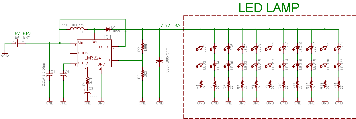

Here is the schematic. I used the National online software for component selection and value calculations. Schmitt trigger introduced me to it. It's pretty awesome.
Thanks for that.
Before proceeding further, Let me start over with a different approach. Can you give me the list of IC that can be used for this sort of work ( designing switching regulator circuits). So that I can check my options, about their availability. If think it will be better to start with something I have access to.
In the schematic why are Cap. in ohm denomination, I usually see them x uF y V.

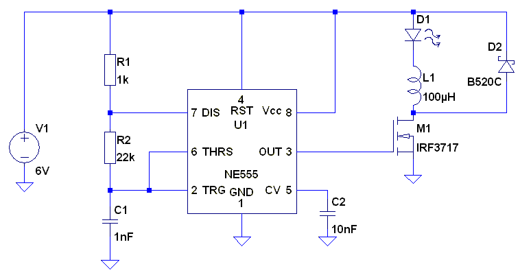

A schematic to start with, is highly appreciable.
For a roughly regulated circuit, see Mr RB's post.
Here's a simple unregulated circuit.
Nice circuit Hero. It will be interesting to see what the OP does with it. I posted a very similar circuit a while ago that used a dedicated IC instead of a 555 but it wasn't "easy" or "efficient" enough apparently.
