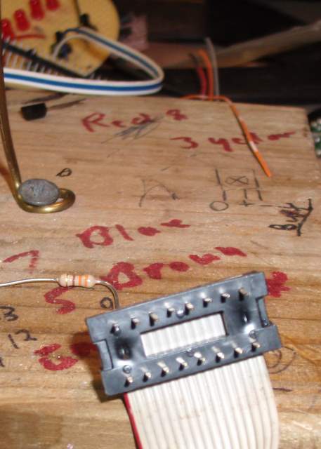

you can do it with this use the socket

well i tried just using the mcuvcc and then the bottom 4 on the left but it didn't look like it worked. I wrote a program to flash an led on portc 0 but all it did was leave the led on it didn't flash and I'm pretty sure its not the code so I'll make a schematic in eagle and post that and then the code I'm using when I get off work but I'm fixing to have to leave and don't have time to mess with it now. Also I wanted to use the internal osc but I'm not sure I'm setting it to the right one because all the osc choices that use the internal osc also selects an external clock for usb and I'm confused on that. I just put it on internal osc for mcu and hs for usb but I don't know if that works or not. Anyway I really appreciate you guys puttin' up with all my questions, thanks.
If you hook it up like this it should work
96-a-gif.2542
use a diode not the 470 ohm
