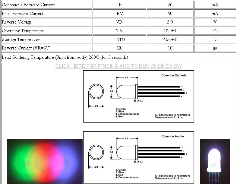

google 'RGB LED' lots of interresting stuff..this one is $1.79..
I was using 1 cent to show how expensive it would be - but then again if you bought 300,000 LEDs you probably could get a fairly good price.

How does one connect up a rgb (or any other led with more than 2 legs)
I understand that normal leds have the power going in the cathode and out the anode.
(i so hope i have that right)
I got a bi/tri colour led.. and.. it ain't working - unsure how to connect it up.

look at the datasheet for the one you are using. they are just several regular LEDs in one package. so powering them relative to the anodes/cathodes is the same... typically they will have separate anodes and all cathodes connected together (common cathode) to one pin, or vice versa.
if you have a multimeter it would only take but a minute to figure it out... put the negative lead on a pin, set the multimeter to diode measure mode... measure all the other pins, if all of them read a diode drop (a few volts for an LED most likely) then that's your common cathode... try all the pins, if you can't find a common cathode, try reversing the leads and looking for a common anode the same way.

i understand that bi/tri colour leds have common anode/cathode etc... I don't understand how to wire it up... e.g. does the + go to both cathodes? and 1 anode grounded?? does it switch between colours... or are both the colours emitted at the same time??

Common annode means it has a common + voltage supply. so when you connect a cathode to ground the corresponding color will turn on.
If you connect all the cathodes to ground, all the colors will light. (thats how it is for my bi-color leds, but Tri-color might be different)
Common cathode is just the opposite.
