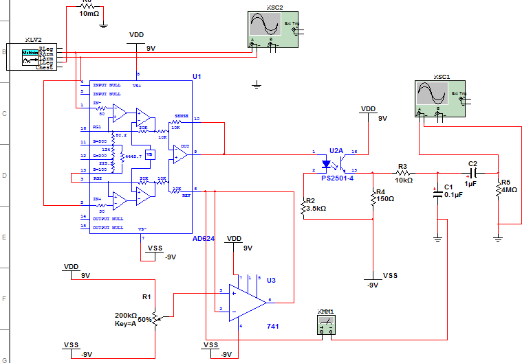

I am abit stuck .... I was wondering if anybody knows how i can add 50hz or 60hz nosie to the input of my ECG circuit simulation to make it more realistic
a picture of my circuit is shown below
any information would be appreciated (improvments or errors i have done )
I was wondering if any one can help with Vin/Vout=Gain
in other words i want to prove it for the ad624
not that good at maths
