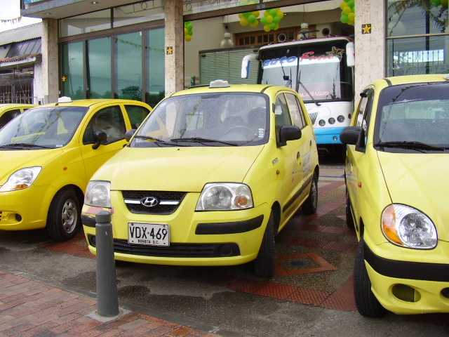

The Hyundai Atoz - Throw it away and buy a real car.
This car (known as Hyundai Atos here) is the most successful taxicab. Enough room for the legs, decent interior materials, consumes very little fuel, It can slip and park everywhere, indestructible mechanical parts, spare parts are cheap (even on legal market), and no specialized mechanics are required to fix it.
Taxicab drivers drive 250 Km daily on them, or even 24/7when two drivers share the same car (one for day, other for night)
No, I would never buy one. They are insafe (lateral and rear impacts) and a predilect target for car thieves (spare parts black market). Give me a Peugeot 207 instead :)
But damn, that Atos it's a REAL car!
