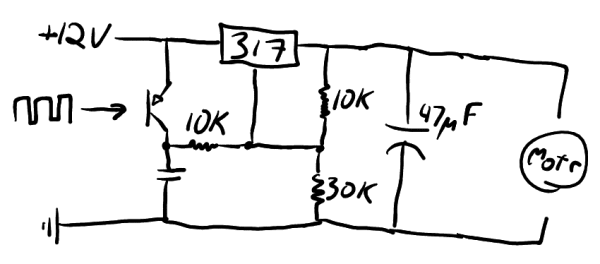

I am trying to control the voltage going into an 18W brushless water pump via a PWM control signal provided on my PC's motherboard, and a 12V power source. Here is what I've research so far:
SOLUTION: Use a MOSFET to quickly turn the motor on and off
PROBLEM: Tachometer stops reporting RPMs correctly. I'm not even sure if a brushless motor is capable of running off of a pulsed power, since my understanding is that it has some controller circuitry.
SOLUTION: Use a MOSFET to charge a capacitor in brief spurts, thus providing a continuous voltage to the motor
PROBLEM: I don't see how this would work. First, let's say the motor consumes 1 amp, and the signal is on 25% of the time. What is to prevent the transistor from sending 4 amps of current to the capacitor, allowing it to provide a constant 1amp to the motor? Let's pretend the capacitor were infinite, it would simple charge to 12 volts and then run the motor at the full 12 volts.
Does anyone know how to do this correctly? I have been thinking about using a voltage regulator, a VFET, or adding a low resistor into to the charging of the capacitor to limit how fast it can charge.
EDIT: I guess what I don't really understand yet is how to model the resistance of a capacitor. Obviously a capacitor charged to 12 volts has infinite resistance in the presence of 12 volts being sent to it. I don't know its "instantaneous" resistance at any other value. For example, let's say I'm trying to run the motor at approximately 8 volts. When the MOSFET switches on, what is the rate at which it would begin to charge a .1 uFarad capacitor?

Err DC brushless work extreamly well with PWM control. What wont is if there is electronics front end.
Just to correct this
Here is what the pump sort of looks like inside. Direct pulsing of the motor is not an option, like I said before, since it makes the tachometer output less than reliable. Let's get back to a way of smoothing out pulsing into a quasi-steady voltage source.
Try a capacitor across the motor, this will act as a simple low pass filter, adding a series inductor would help as well - but for directly feeding a motor values are likely to be high. Usually you would use small values feeding the input of an opamp buffer, and get a smooth DC out of the opamp (which you could then buffer with a driver transistor to feed the motor).

OK, that's a new term to me. Is that the same thing as a VFET? In other words, a power transistor, which instead of turning on and off, tracks the control's voltage?
I've been searching patents and I found a diagram of what is claimed to be a "simple PWM controller". It's very similar to what you are saying. Basically, a capacitor across the load, and an inductor (or rectifier?), but the inductor is in series before the capacitor. Finally, it has a low-side transistor which I assume is turned on when the high side is off. So in other words, you create A/C. I guess the inductor needs to be able to draw current from ground when the PWM signal is switched to low.

It could be either bipolar or a FET, it depends on how you design it.
Yes, the inductor needs to be before the capacitor, it's a standard low-pass filter.
Ok, so here's an inductor in series. When the MOSFET is turned off, where does the current go? Do I just stick a diode in to allow the current to loop back around?
Will this circuit create too much RFI for a PC? I'm pretty sure a benign frequency has been chosen for the PWM, but switching 1 amp can create a lot of noise, can't it?
Is it possible to use a voltage regulator, and have the PWM signal used to vary the control signal to the voltage regulator? It would still be some kind of transistor+capacitor combination, but it would be at very low current and not produce as much RFI. As a bonus, I could wire the voltage regulator such that I could guarantee some minimum voltage at 0% pulse width.
Anyone? What is the maximum output voltage I could get from a voltage regulator with 12V going in? Will it damage the voltage regulator if I short the input and outputs together, so that Vout = Vin?
Here's my idea:
Use a voltage regulator and PWM to modify the input to the reg.
When the signal is off, the VReg's input is determined by the two 10K and 30K resistors. This would make the output 1.75V times 4. When the signal is completely on, the VReg's input is determined by 3 resisters, two 10Ks in parallel, i.e. 5K, and the 30K. Which means the output voltage would be 1.75V times 7, or basically the maximum output of the VReg.
A 50% duty cycle would charge the capacitor half the time, hopefully resulting in some voltage between 7 and 12.
Can anyone help me in choosing components such as a low drop regulator, and capacitor sizes. THANKS
