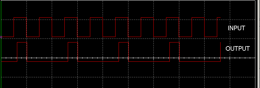

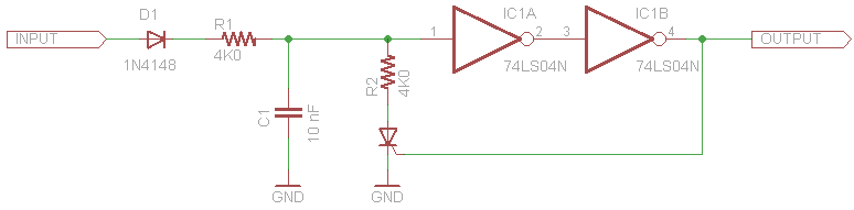

While I think the digital solution is still by far the best, your original question about using an RC delay has been bugging me. Today I had some time to simulate a circuit I dreamed up:
edm-sch-png.58280
And here is the simulation with Multisim:
edm_cutter-png.58279
The circuit is quite sensitive to the component values, particularly the two resistors. These values essentially drop one of the cycles from the input. That is, it takes two cycles to charge C1 sufficiently to trigger the inverter. (The existing buffer IC on your board could probably be used instead of two inverters.) I do not believe you can get the output on-time to equal the input on-time of a single cycle with this circuit, but you can get close. Alternatively, a small change in the relative values will give the same frequency as the input, but a shorter duty cycle. That is, the on-time during a cycle is considerably shortened.
Anyway, at least I got this off my mind.
John
