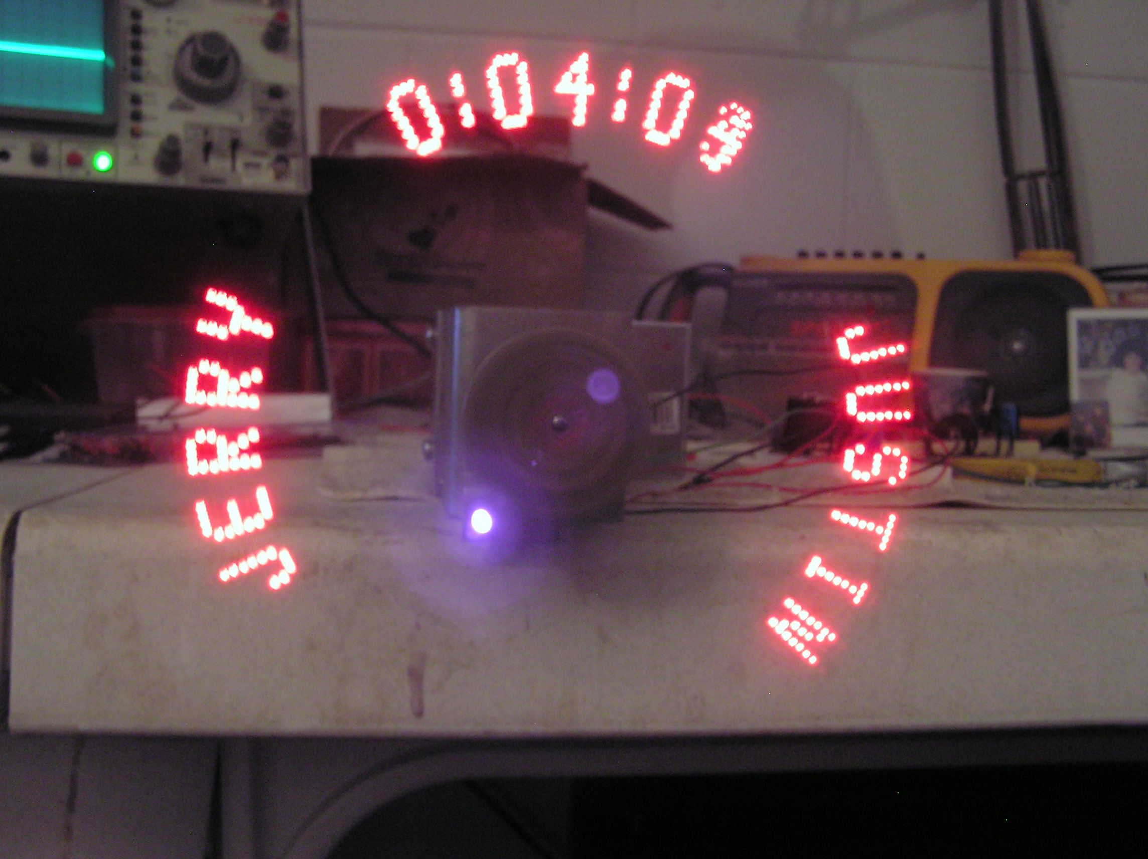

All I've ever bought is a prototyping board, wire and some components
from Radio Shack and Mouser Electronics. I've attached a photo of my
microcontroller digital clock and propellor clock. Six months ago
I didn't know what a microcontroller was.
"Justin" on the prop clock is my 11 year old grandson who's learning
out of this book and can build most of this stuff himself.
jerryd
