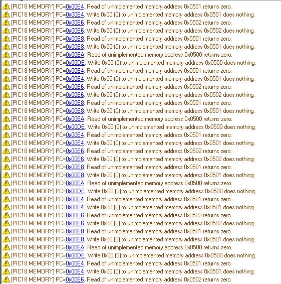

Thank you Pommie for the suggestion, i tried it and it but the problem still exists. However i noticed that if i comment everything in my main() function, it is still giving errors.
Attached is the errors (warnings) from simulation.
Can it be that i have to setup some register in main function.
It is giving all these errors even with main function such as
void main(void)
