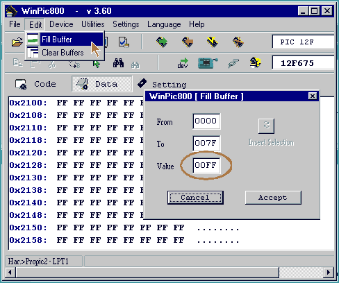

Many programming software has the option to allow user to edit or fill up the EEPROM buffer before downloading to the PIC.
See the image for an example.
