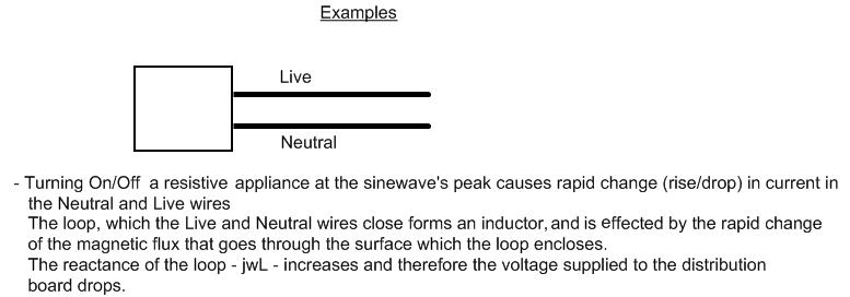

Is this example that i wrote correct please?

[quote="alphacat, post: 802628"]Is this example that i wrote correct please?
Hi alpha,
I think you are getting yours 'terms' crossed.
Look at this link for definitions.
Electromagnetic compatibility - Wikipedia, the free encyclopedia
If a triac/scr is designed to switch at ZC of the mains wave, the power to load increases from zero as the mains phase sinewave voltage increases.
Without ZC detection, as you say, switching at mains peak could occur which would try to drive a high current thru the load.
This can cause electromagnetic radiation from the wiring and the load, especially if its an inductive load.
The problem that switching at zero-crossing attempts to fix is L di/dt where the L is inside the appliance (motor, transformer, ballast), not in the AC line wiring.

So, about the example i've given,
is it correct that the rapid change of current (due to de/activating an appliance at the sinewave's peak) will cause the jwL of the loop closed by the LIVE and NEUTRAL wires to grow,
and therefore the distribution board will experience a voltage drop? (Or am i exaggerating and no voltage drop will occur?)

Look up Lenz's Law.
http://hyperphysics.phy-astr.gsu.edu/Hbase/electric/farlaw.html#c2
Faraday's Law
But the rapid voltage rise-time of an SCR/Triac turning on at other than the zero crossing will generate significant EMI, independent of the load type. I'm sure you've heard the buzz from a lamp dimmer in an AM radio, for example. So reducing EMI for any load, even resistive, can be a a reason to use zero-crossing turn-on.
