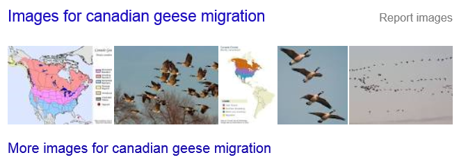

There are no "Canadian Geese" if you have one it is a Canada Goose and if you have more than one they are Canada Geese. The operative word here is Canada, you are familiar with Canada I would assume. Canada is where the Canadians live but the geese that live there are Canada Geese. The ones around here no longer even migrate. :)
Ron
I guess Google is American so Google and I (I am not American) got it wrong.
Actually I guess it really matters not (Canada Goose or Canadian Geese) because dinner by any other name is still dinner. :)
