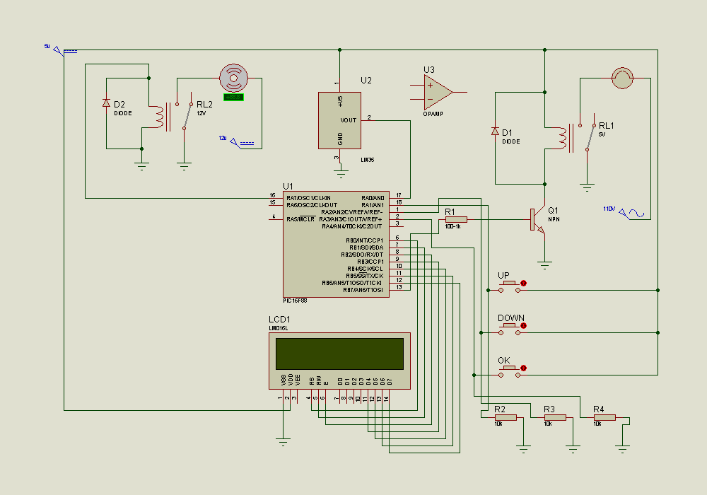

Hello Guys,
im trying to create an egg hatcher using a pic microprocessor. Im going through a lot of trouble since im not used to circuit design. I want to create an egg hatcher that will check the temperature and activate a lamp to warm the hatcher. Besides that a motor will be activated periodically.
I started the schematic with a PIC16F88, a LM35 sensor, a LCD display and a stepping-motor. Is my schematic ok?
Comments and crits really apreciated

You need to have pull-down resistors on the three switches.
You need to have a stepper-motor driver IC between the PIC and the stepper motor.
Without an opamp amplifier between the LM35 and the A/D input, you will not have sufficient resolution in the A/D readings.
Hi artefon,
I suggest to use a 10 to 100nF decoupling cap at the analog input (AIN0).
A stepper motor can't be driven directly out of the MCU. You'll need a driver circuit.
I suggest to skip the stepper motor and use a DC-motor instead with two Hall-sensors signalling the right and left limit. Without counting the actual steps of the motor the egg turner will probably empty itself if the number of steps varies between left and right rotation.
I also doubt you can achieve a constant equally distributed temperature using a lamp. This will result in different hatch times and probably fry the eggs near the lamp.
A better way is using a small fan with air guides inside the incubator and a nichrome heating element in the downstream. Don't forget to add fresh air and vent holes in the incubator box to prevent the eggs from rotting.

Thanks a lot Mike,
1) I added the pull down resistors.. are they ok?
2) I thought that the stepper-motor already came with a driver... should i go for a continuous motor?
3) Should i use the opamp with a 5 gain?
sorry for the dumb questions, im willig to get to the programming part ;)
They only have pullups and in the case of the 16F88 only on port B.
He uses port B for the pushbuttons. So he could activate by switching to ground and have the I/Os internally pulled up. (saves about 5 Cents :) )

Thanks a lot for the help!
Actually im using PORTA so i'll have to use pull-down right?
About the opamp, is it really necessary? i could read values between 0 and 1 without it. What is the reason to use it?
Another update: Added relay for 12v motor.
The port pin cannot drive the relay, either. The port pin is only capable of sourcing ~25mA@ 3V; you will have trouble finding a relay that sensitive. You will need a grounded emitter NPN transistor, whose base is driven from the port pin through a current-limiting resistor; and whose collector drives one end of the relay, and where the other end of the relay is connected to 12V (not 5V). Depending on how much current the motor draws, you can probably just use the transistor to drive the motor.
The LM35 puts out 10mV per degree. If you use 5V to power the PIC, and if you set up the PIC's A/D so as it uses the 5V as its reference, the 10 bit A/D will quantize the range from 0 to 5V into 1024 steps, or ~5mV per step. That will allow temperature to be measured in ~ 1/2 degree steps. If that is good enough, then you can dispense with the opamp. If you set the opamp up with a gain of 10, then that will give you 20 A/D steps per degree.
He might as well narrow the A/D conversion to the required temperature range. Temperatures below 37.5deg/C are of no interest for an incubator. If he uses temperatures from 35 to 40 deg/C the resolution will be higher.
Ergo, the opamp with a gain of 10, with offset adjusted to center the temperature of interest at 512 on the A/D

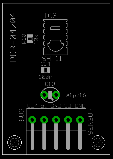

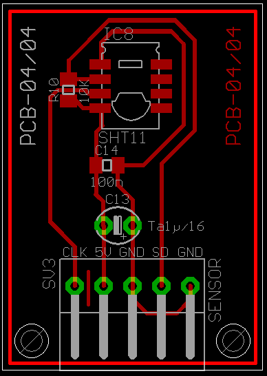

Hi Hugo,
you should look for the SHT11, which is the same as the SHT75, but doesn't have a male pin connector. It is much cheaper than the SHT75.
For a humidifier I recommend a so called "cold mister", used for small fountains as a decorative add on.
You might find them in aquarium shops.
Here is the PCB layout using the SHT11. Dimensions are: 31.75X22.5mm (1.25X0.8875")
Regards
Boncuk
