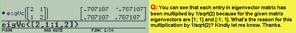

I believe this is what eigenvector and eigenvalue concept is all about. This is the link I refer to in the previous linked document.
Please also help me with this query. Thank you.
You can think of eigenvectors as directions (even "preferred" directions), even though they are not necessarily representative of directions in space. If you multiply an eigenvector by a scalar constant, it is still an eigenvector. Often, people prefer to scale the vector to have a magnitude of one. This is similar to defining a unit vector for directions in space.
Thank you, Steve.
So, the calculator was scaling the eigenvectors to have a magnitude of one.
Best wishes
PG
