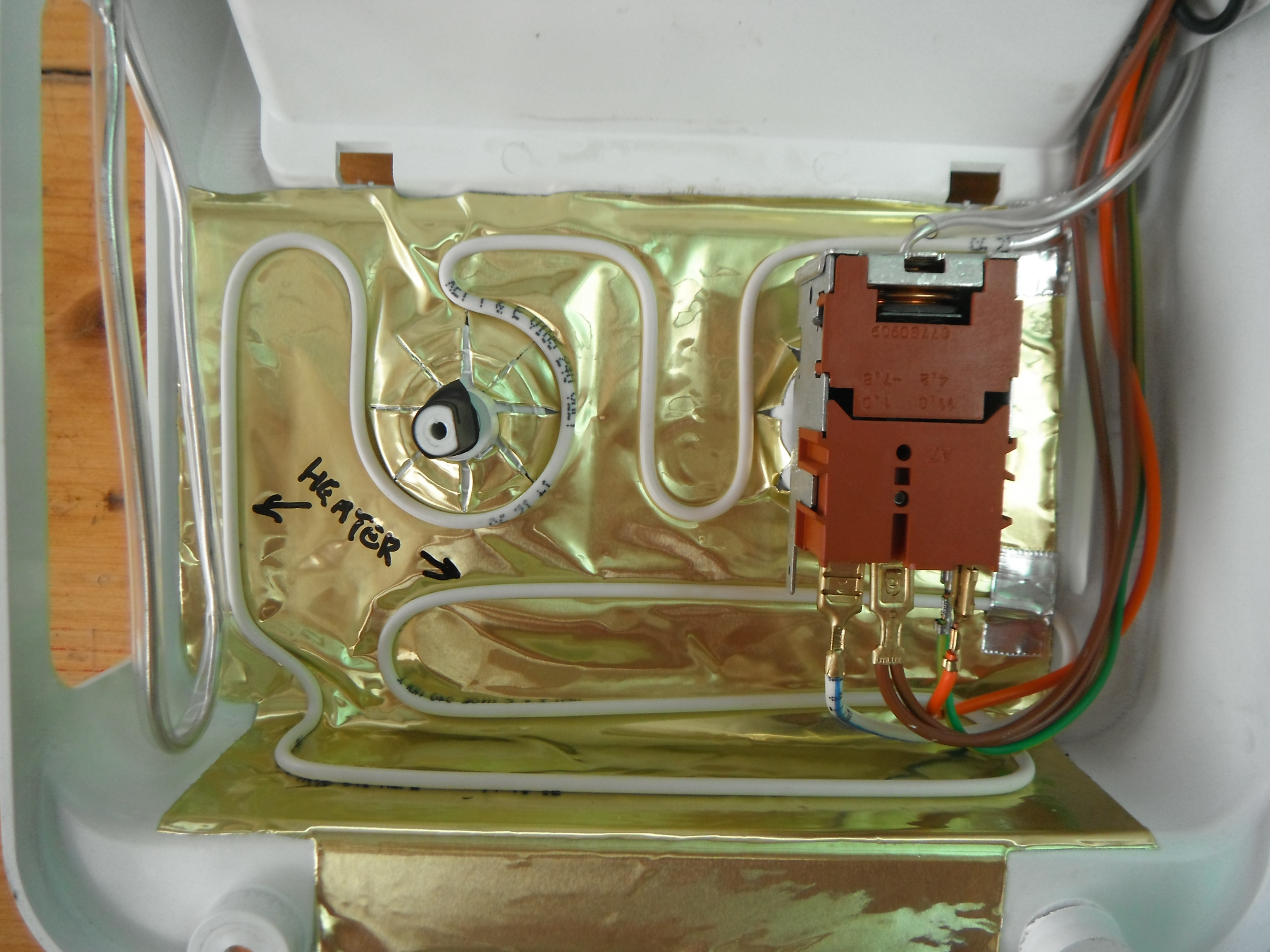

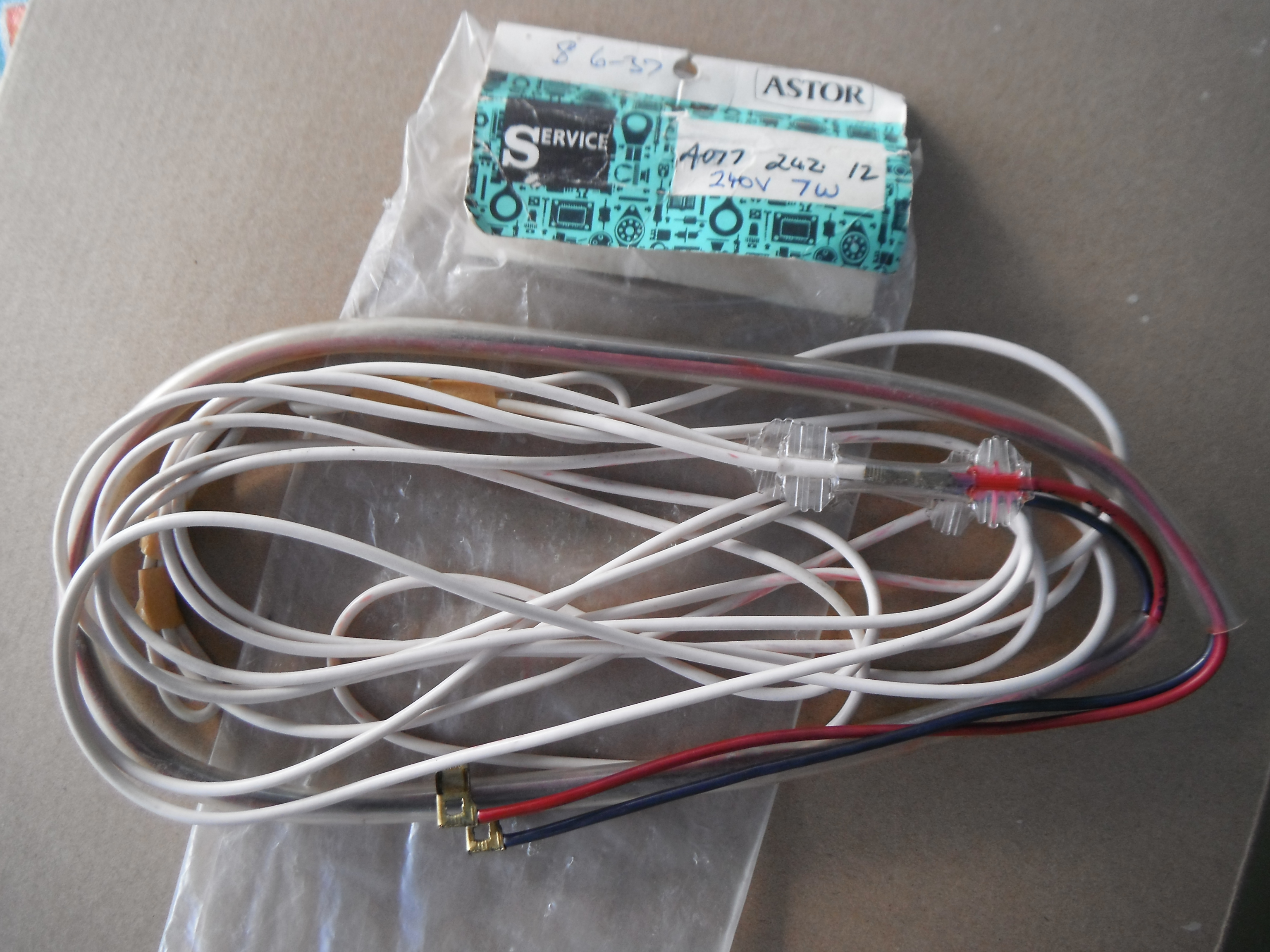

This may be another option if its still avalable. Its a insulated resistance wire used in refrigerators as a heater for defrosting parts.

They are normally resistance wire (probably like the insulated resistance wire posted by Debe) in a flat pad made of flexible hard rubber/plastic material so it can be wash-n-wiped.
Making a large area heater from resistors is "messy" as you have to mount heaps of resistors, then run heaps of wires in between them, then try to goop it all up with silicone etc to seal it into one safe reliable thing. A ready made heat pad is so much easier, or even just the resistance wire Debe mentioned.
