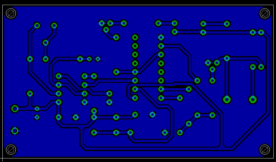

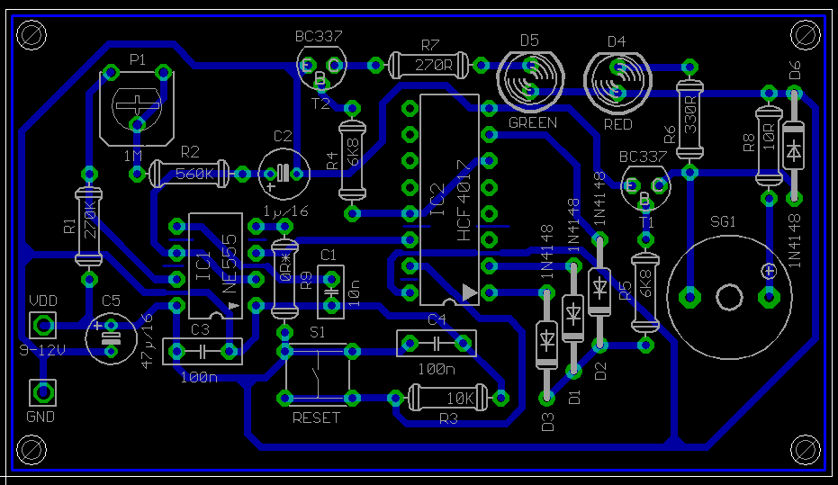

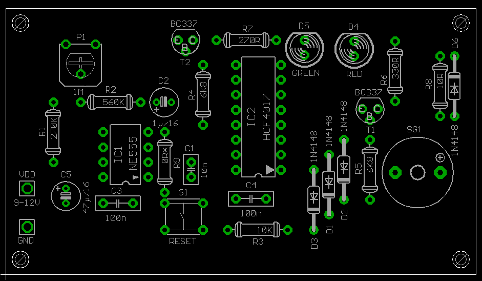

Hi ESchreiber, (typical american name :) )
I suppose you don't want to make the final design on a breadboard.
Thinking ahead I've also designed a PCB layout for you.
Just PM me to obtain the Eagle files. The layout is pretty rugged and should work properly even if handled roughly.
I've added a pot to set the speed from 1Hz to ~0.3Hz. (just in case the beeps are too short. :D )

Thinking ahead I've also designed a PCB layout for you. Just PM me to obtain the Eagle files. The layout is pretty rugged and should work properly even if handled roughly. I've added a pot to set the speed from 1Hz to ~0.3Hz. (just in case the beeps are too short. :D )
Thank you very much! No need to send the Eagle files - I don't have the application, and I've got waaaay too much software to deal with already. The GIF files you attached should be more than adequate.

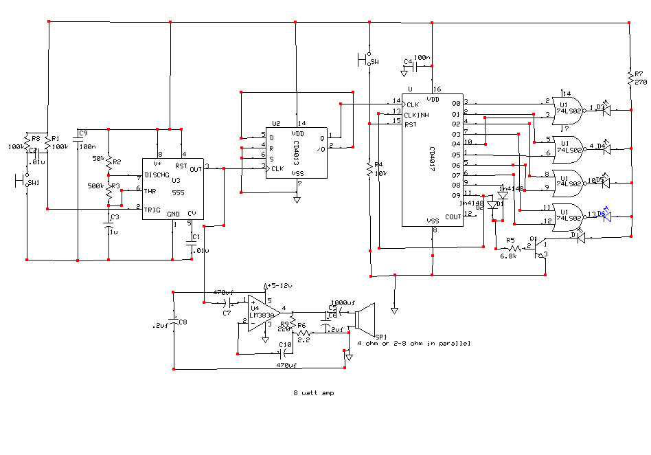

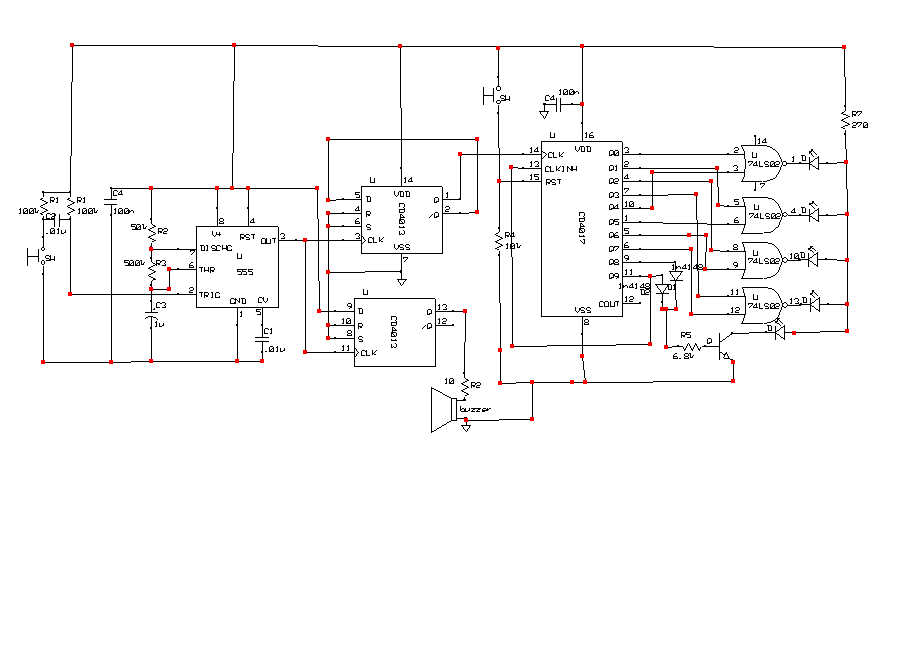

just read and thinking basically same but
why not slow the clock down (555) then connect to every other output of the 4017 and have 4 red leds then have the green led connected to pin 2 and 4 with pin 15 tied to pin 3 for halt
OR
throw in a flip flop and divide by two then cycle the leds randomly or round n round or ??
this could be fun
here is my interpertation
this will flash the LEDs in order 1,2,3,4,1,2,3,4 at approximately 2 second rate
while buzzer is pulsing at 1.3 hz
might speed up clock (add pot to 555 circuit for adjustment)
lots more action but more parts
basically same as Bocuk but clock is divided by two and output LEDs flash separately

go for about 50 watt amp
that should really make an impression--lol
be nice to get your hands on a SN76488N sound generating chip
lets see an LM383 8 watt amp would do the deed unless you want MORE POWER go with a 16watt bridge amp using 2 of the LM383's
A circuit board could be designed and etched (one is already posted but only has one LED.
been playing w/ design using the schematic I posted.
how big of an amp?? desired.

same but w/ 8watt amp
same circuit but removed 1/2 of the flip flop, added an LM383 8 watt amp

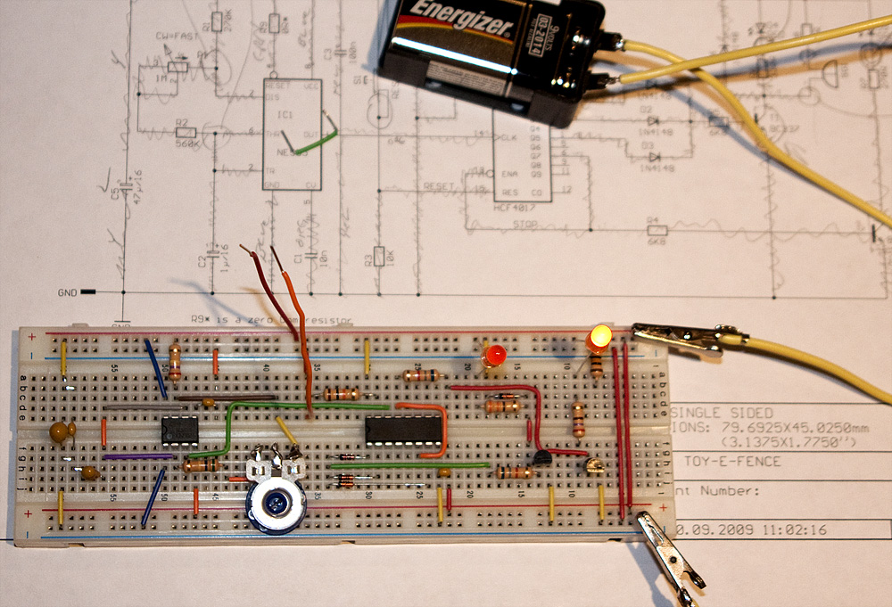

Followup
I don't like when folks show up, get what they want, and disappear, so I figured I'd drop in for a followup.
First, I had to do a bunch of research to find out what the various notations for the design that Boncuk provided meant. I had no idea anymore what 47 uF/16 or 6K8 meant. So I lurked around here and searched resources on the net, and learned what I needed.
Then I blithely went off to Radio Shack to purchase the parts. Ooof. Radio Shack isn't what it was when I was a high school electronics hobbyist 25 years ago! I bought an assortment of parts, but not nearly the full set of what I needed - just the diodes and most of the resistors.
So I came back here and looked for names of online parts suppliers that would deal with tiny lots like I needed. I found DigiKey Corp. | Electronic Components Distributor | United States Home Page, and they had almost everything. All they didn't seem to have was the etchant solution (unless I wanted to get into some high-end photographic setup) and the dry transfers for laying out a board. I'll be taking all the parts I got at RS back this week. Digikey had much better prices. How do they stay in business? Surely it cost them more than 29 cents to have someone pick resistors five at a time!
Anyhow, all the parts arrived in about 3 days - nice! I headed off to the local Fry's electronics store for the etchant (which they had) and the dry transfers (which they didn't). I'm coming down to my deadline here, and didn't want to get stalled for lack of transfers. But a solderless breadboard caught my eye, and I abandoned my fancy etched PC board notions.
So finally this weekend I sat down and built the circuit on the breadboard. No doubt you guys are experts who could have whipped it up in 30 minutes or so, but I muddled with it for several hours. I'm very anal retentive, and I wanted everything nice and tidy. And, I admit, I was having fun - it has been far too long since I played with this sort of thing!
Tonight I jury-rigged the push-button switch. I admit that I had no expectations that it would actually work. Far too many opportunities for failure - picking the right parts, connecting the circuit correctly, pointing the diodes and caps in the right direction, etc. I attached a battery and...
I'll be damned. It actually works! Exactly as Boncuk described. I now have three evenings to assemble the circuit into the base of the toy (away from prying hands). I'll have to look up if LEDs are supposed to be in series or parallel, since there are 8 of each color ranged around the top of the electric fence.
Anyhow, I wanted to drop in and say thanks to everyone for the discussion and this most excellent website and community, and thanks especially to Boncuk for the plans!

leds should be in series
a good cheap etchant is 1 part muratic acid, add to acid 2 parts hydrogen peroxide
not as messy as the brown etchant. you can see your progress.
For this simple circuit RS sells several proto boards that could be used but an actual pcboard is better.
after all is working be sure to spray a protective coating to prevent oxidation.
Glad the circuit is working. However you can't connect 8 LEDs in series using a 9V battery.
All you'll see is dark LEDs connecting 8 in series.
Here is a revised schematic. Connect three strings of LEDs in parallel, two of them containing 3 LEDs and one containing 2 LEDs.
Please note the changed values of current limiting resistors. The resistors are calculated for a forward current of approximately 10mA for longer battery life time.
