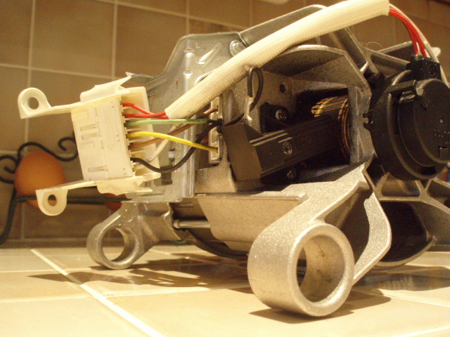

Hi, i took this motor out of a washing machine.
Anyone know what all the wires are for?

Hard to say exactly. But it looks like you have a reversable DC or univeral type motor. two of the wires run the field coils(the stationalry ones on the outer part)Two of them will go to the bruches. and it also looks like it may have some sort of speed sensor on the end.
Try putting the field and brush wires in series. That should spin it up. but if its a DC only it may not run very well on AC that way. To reverse it just reverse the connections one either the field or the armature.
Can you give us a model of the wash machine? Perhaps some one here has actual schematica or hands onexperiance with it. then they can tell you exactly what you have and how to hook it up.
If it was from a very new or commercial machine, it could also be a three phase motor used with variable frequency drives.
Nope! Take a look at the pictures closer. I see a commutator and a set of brush holders! dont you?
Looks like a "universal motor" to me, too. The white and black appear to be the brushes, yellow and brown are probably the field. That thing on the back with the two red wires is probably a magnetic speed transducer, it has a coil and a magnet on the shaft, gives you a sine wave with a frequency proportional to the speed.

I can confirm that the black and white wires go to brushes.

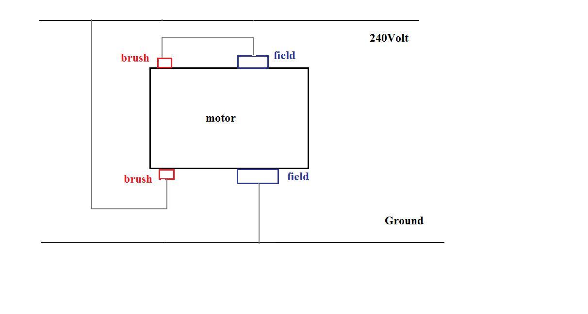

When tcmtech says try putting field and brush wires in series, does he mean how i have drawn my sketch?

Are you sure it's parallel wound? Most motors like this tend to be series wound.

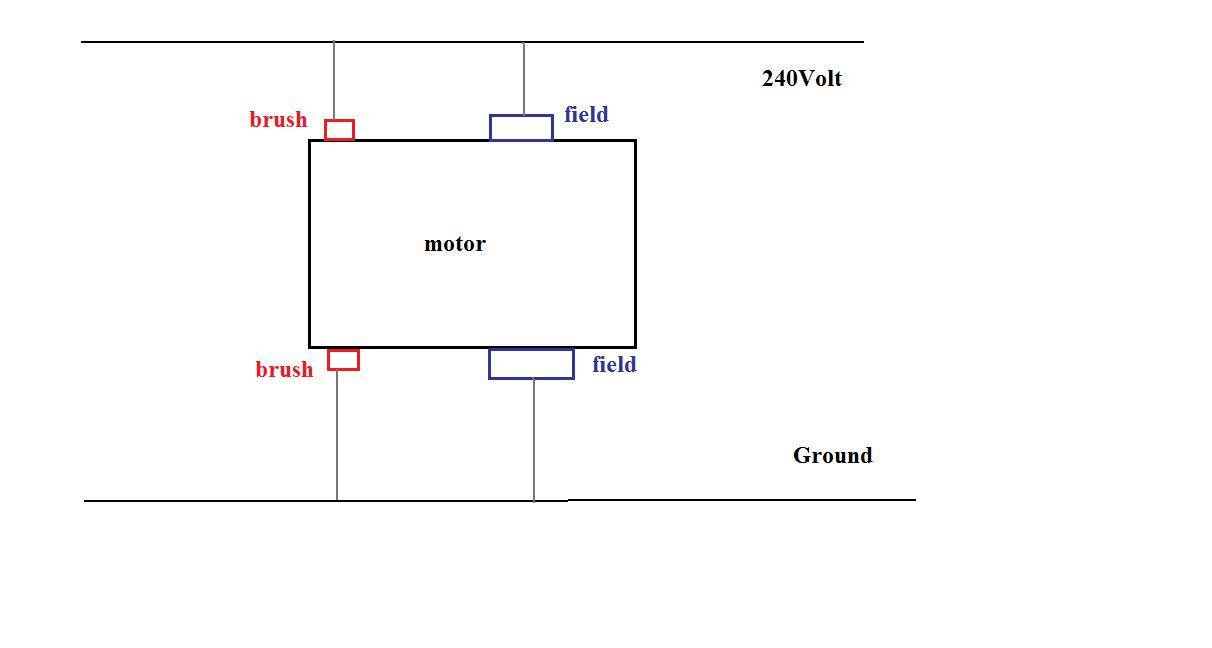

i have no idea if its parallel or series wound. I'm not exactly sure what this means, is this when brushes and field are inline, so i would then connect my motor as in my new sketch below?
How can i tell if its series wound or parallel wound?

I would go with the connection that you have in the second post. And like they said try it at a lower voltage first.

I have been looking at the pictures more closely and I think the field windings look like they are not a fine wire but a heavier gauge that would be more common to a series motor. Typical higher voltage shunt wound motors need to have the field windings covered to keep the fine wire from getting damaged. Being the field windings are open like yours strongly sugests its a series type motor. ;)
